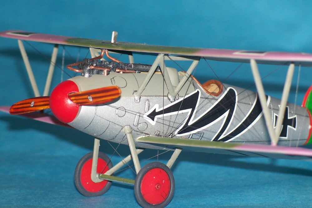

Chris Bucholtz Posted November 17, 2021 Report Share Posted November 17, 2021 I use .1mm nickel-silver wire from Albion Alloys. I measure the length carefully, and install it with tiny beads of scenic glue. For runs of less than 4 inches, it stays rigid - perfect for 1:72 scale. A package lasts two or three fighters; if you're building an F.2A or a Gotha, get a couple packages. 🙂 Link to comment Share on other sites More sharing options...

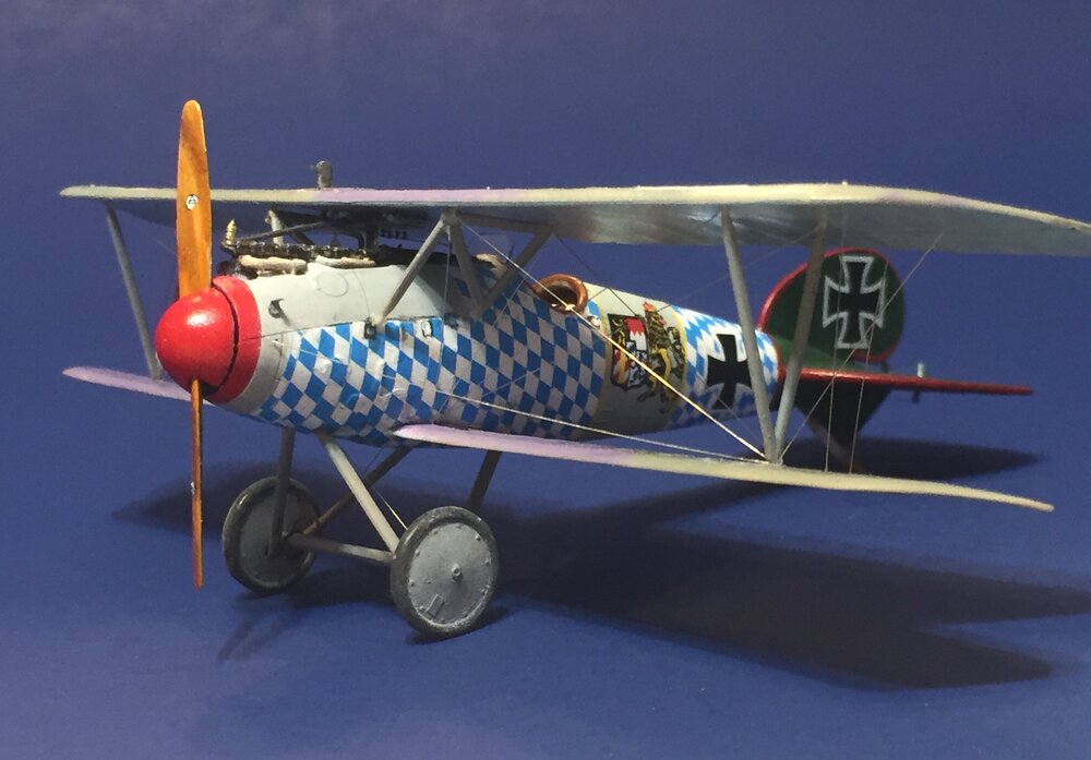

TheRealMrEd Posted January 30 Report Share Posted January 30 Another vote for invisible thread! The hardest part, is drilling all the very tiny holes! After that, I secure the anchor end with a tiny drop of CA cement. After that dries, I pull the length of thread (cut excessively long) through the hole in let's say the wing. I then put tension on the thread, using a tiny alligator clip, etc. (Fly-tying hackle pliers work great for this!). Sometimes I have to put something, like a box or paint bottle, against the model while I tension the thread, just enough to pull it taut. Then I apply another drop of CA where the thread exits the top or bottom of the wing. When dry, trim closely, sand if needed, and touch up the paint. I usually paint the wings first, but leave off the decals. Then I rig, then touch up or over-spray the top of the top, and bottom of the bottom, wings... Start with something simple, like a Stearman, before tackling the giant bombers! Best of luck, Ed 2 Link to comment Share on other sites More sharing options...

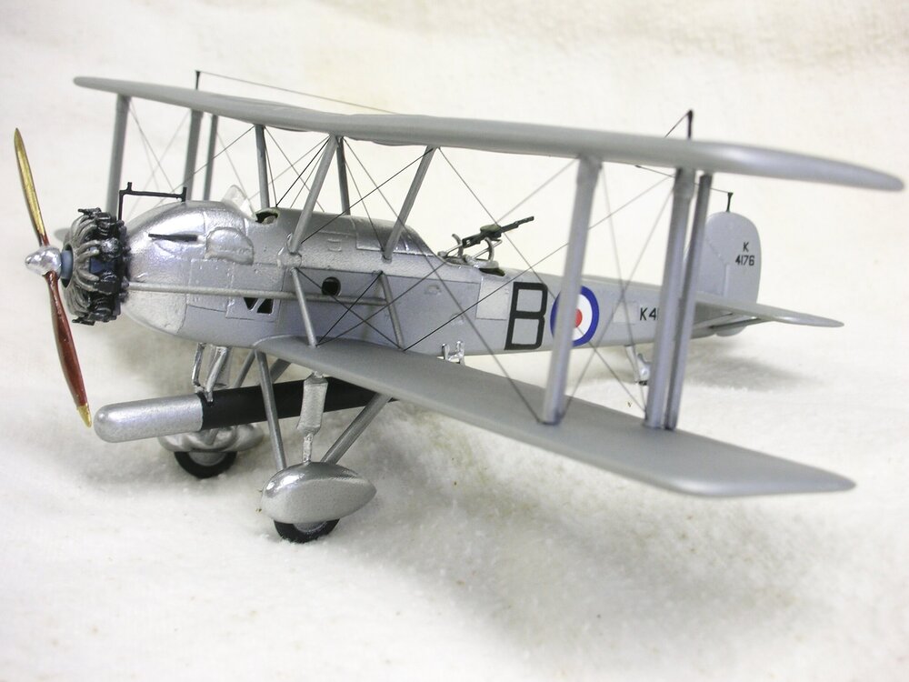

Ron Bell Posted March 20 Report Share Posted March 20 I'm a bit of a throw-back and go old school with stretched sprue. Heat it, stretch it to the appropriate thickness, let it cool, cut it a tiny bit longer than needed, glue into place with a drop of white glue. When dry, if it is sagging, put a toothpick in a candle flame and let it light. Blow it out and then place the rigging line into the smoke (or visa versa). Slowly draw closer until the sprue snaps tight. Get too close and it melts, but it's easy to start over and no harm done. Some sprue stretches better than others and maybe best of all, it comes in all sorts of colors. This is the 1/72 Contrail Vacuform Wildebeest. 3 Link to comment Share on other sites More sharing options...
