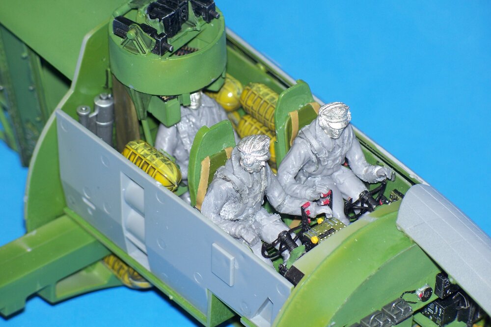

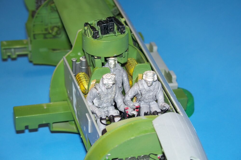

Got the pilot, copilot, and top turret gunner placed this week. Once more, it took quite a bit of reposing arms and legs to fit into the cramped confines and fit the controls somewhat...

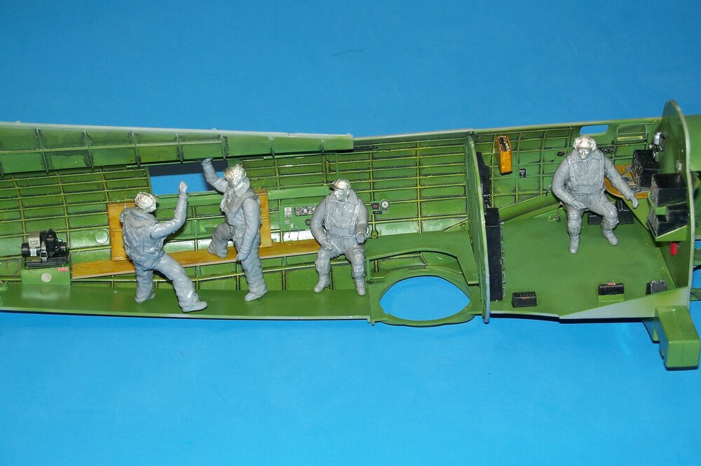

The last 4 figures have been reposed and positioned! The 2 waist gunners, for which I used standing "top turret" figures needed considerable altering of the legs since the floors are uneven, as well as an arm reposed to help support themselves. The rearmost figure was also slightly bent at the waist to make him a bit stooped and fit in the lower ceiling farther back. The radio man and the other crew member were used almost as is. The 2 standing figures are held in place with the help of a bit of wire in the shoe bottom that anchors them to the floor.

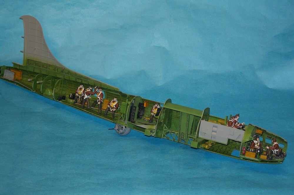

Finally finished painting the figures....repositioned the turret gunner to the waist as he was going to interfere with the fit and ability to remove and replace the top fuselage section, which will remain removable.
267246898_505369130765112_4901067217730811071_n.jpg.810bf11fc5a6cb74c65d5ce916263d83.jpg
270114317_926303561592160_8486903101423938927_n.jpg.8a6e6947042e0503675d37d06982889f.jpg
268178036_342573387688251_3134617721804072933_n.jpg.334e79eeceeb5203cba58690c5ace672.jpg
The ball turret is just sitting in position...next step is to close her up and start sanding seams!

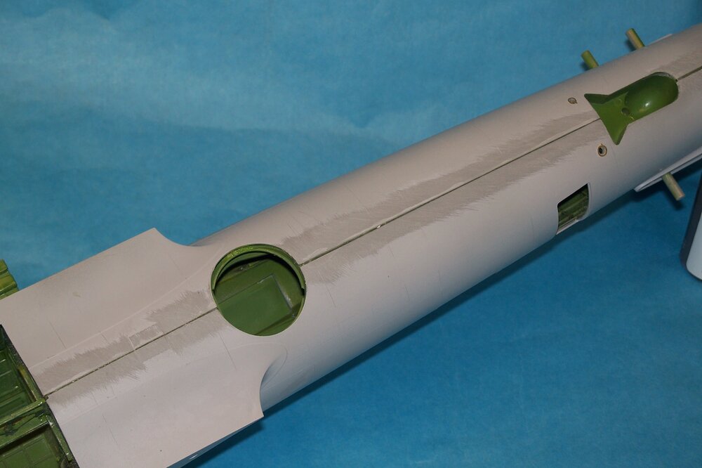

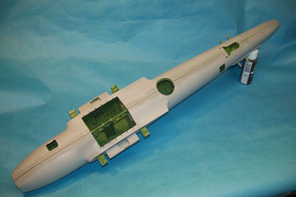

To start the new year I can post a major step forward: the fuselage is now together!
The fit of the halves was good to marginal, as can be expected with a large kit with a LOT of interior detail that has to fit inside precisely to get a good fit. Some sections fit pretty well with a "normal" seam, while other sections left 1/16-1/8in gaps. All of the seams were filled with gel superglue and immediately sanded smooth.
The separate top section was also worked on, as the client wants it to remain removable. The windshield and side glass parts were cemented in place (EXCELLENT fit for those!) and some trimming and sanding done to get the best "loose" fit when placed on the fuselage, including shaving the outside shoulders of the pilot and copilot.
There's still a ways to go to get ready for the tail planes and wings to be added, but at least this may be the first true step towards "finishing this project!

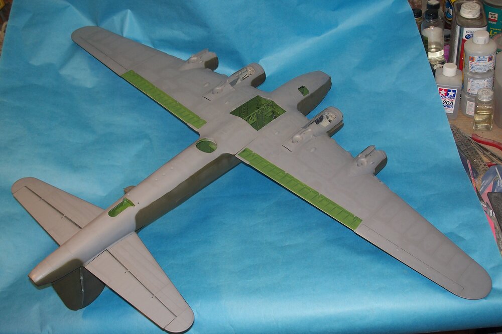

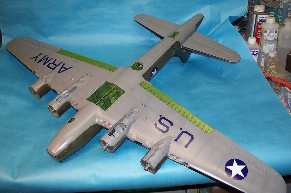

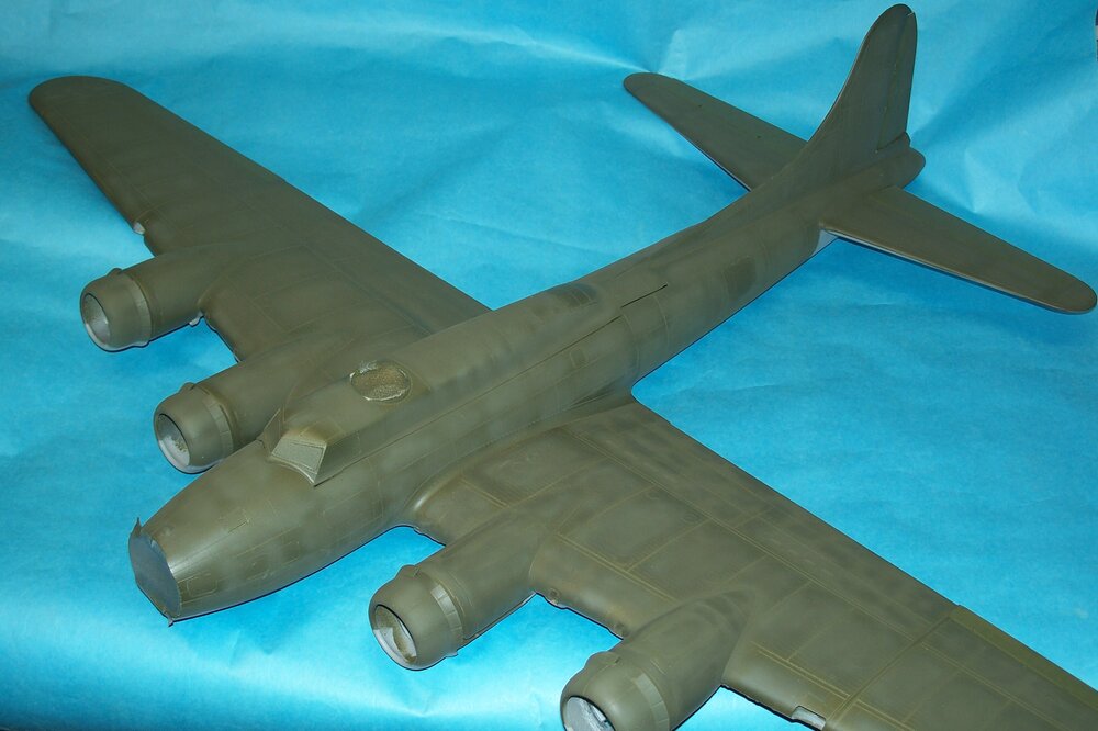

Now we're getting somewhere.....the initial painting is done! Base coated the tops and bottoms (painting the fuselage and wings separately) with Tamiya rattle can OD and Neutral Gray. The masking for the demarcation lines was done with Tamiya tape, rolled up lengthwise; with the big areas behind it masked off with blue painter's tape.
I then spent most of this afternoon airbrushing MM 34086 OD and Neutral Gray to touch up the camo edges; followed by lightening both paints to get slightly lighter colors for post shading; which was then followed by a light misting of the original colors to tone down the post shading.
A second, lighter OD color from Tamiya was used for the fabric covered ailerons, elevators, and rudder; and they were counter shaded in the same manner. There's still quite a ways to go on the finish with general weathering, panel line emphasis, chipping, and exhaust stains all yet to be done. But that's for next week!

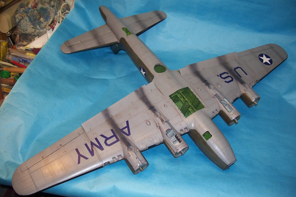

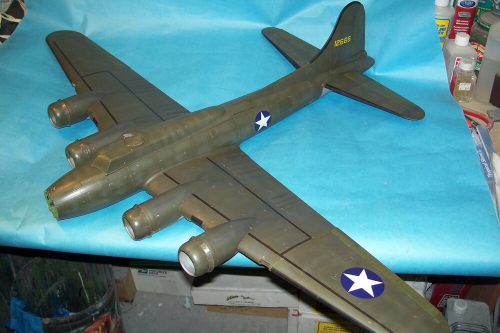

Added the de-icing boots, wing walk lines, and the markings last week, as this all needed to be done before any weathering. Starting to see the end of this project!
GIL :cool:

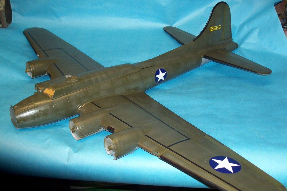

The weathering is as done as it's gonna be.....I applied a brown sludge wash, airbrushed the exhaust stains (several times), toned them down, and then also used some pastel powders in the end. Some random chipping was added this evening.
Might have her on her gear this weekend!
GIL :cool:

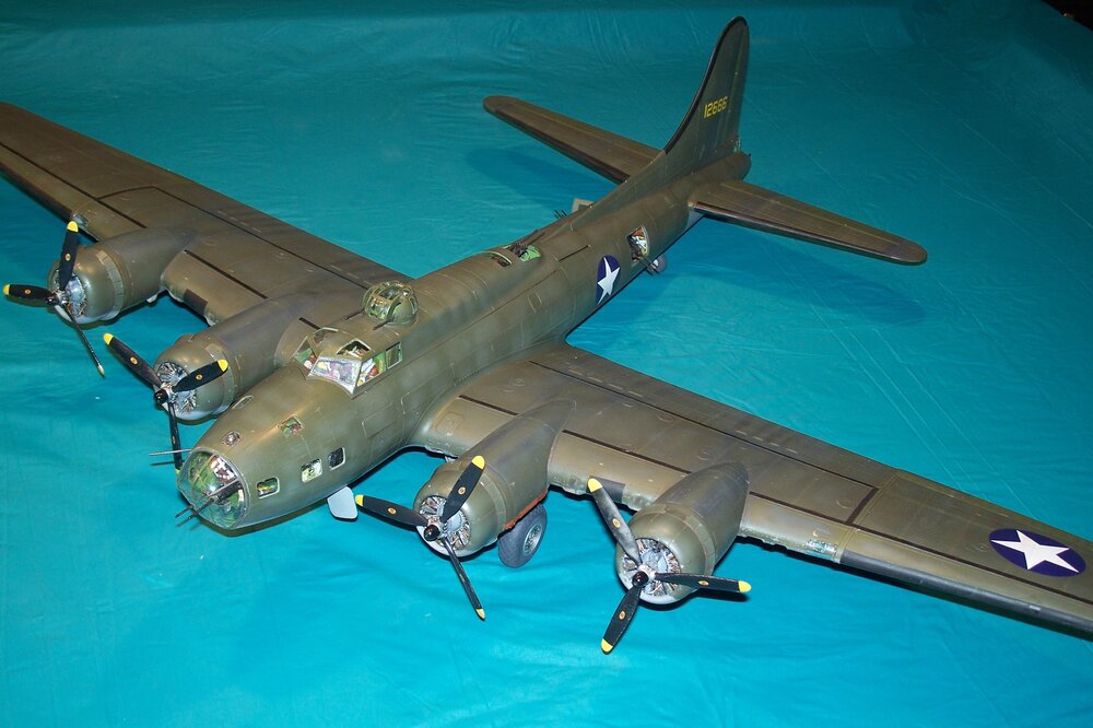

Yes...even with the removable top the detailing and figures in the waist area will be tough to see...but that's what the in progress pics are for! The model is finished! See the A/C topic for more pics.....
