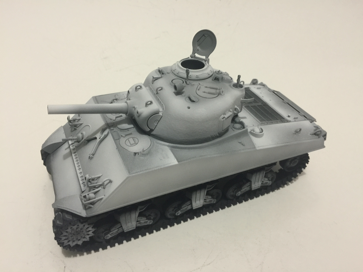

The fun part begins, using black and white from Tamiya, the step 1 of the black & white modulation.
Step two of the Black & White modulation continues with detailing white parts using a brush with Vallejo white.
 Look how the parts painted in brush pop out of the kit!
Step 3 of the Black & White Modulation adding glazes of Black, pin washes to underlines lines, holes, etc.
 Some pre weathering also started.

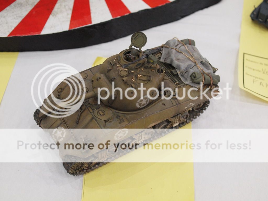

Well this fella has come to the finish line, Dust and mud added, figure done, lens lights added using Sticko silver dots, stowage is handmade using Aves Epoxy, just need to add a rope and some loose tools. Hope you like it, its a great kit considering the old it is.
P1079169_zpsll79bs6t.jpgP1079171_zps2byamana.jpgP1079184_zpsarro5inv.jpgP1079181_zpsbkoqxjyu.jpgP1079190_zpsa29kccs4.jpgP1079189_zps9mgc9ntz.jpgP1079195_zpsqurimn2l.jpg
So on this final animation you can see the whole process in seconds to the final stage. Hope you like it and can help you work on yours!
I added some 50mm caliber ammo cases around the turret to add more realism.
Oh nice! I love the spent .50 brass on top of the turret. That is an excellent touch.
Magnificent! What am amazing model! I love the animation too; really helps to watch it come to life.
