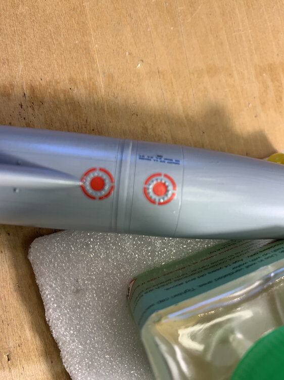

I followed the exacto/decal set solution method to get the decals on the fuel tank to settle down.  It worked great at the locations where I actually placed the decals in the right spot.  The photo shows these, one being a little off center but it still settled down nicely.  I am happy with the results, thanks!
A48C7BA2-DB4C-435C-BFDF-C9D364BF9A44_1_105_c.thumb.jpeg.f6f3b865fd343a29eaf38a409ca09b02.jpeg
Oils, with Mona Lisa thinner, work fine on top of both enamels or acrylics. That thinner is mild enough to not attack the enamels as long as the paint has dried and cured. Usually that is at least 24 hours depending upon temperatures and humidity. You should have zero problems of bad interactions between oils as your washes and acrylics as the base coat.

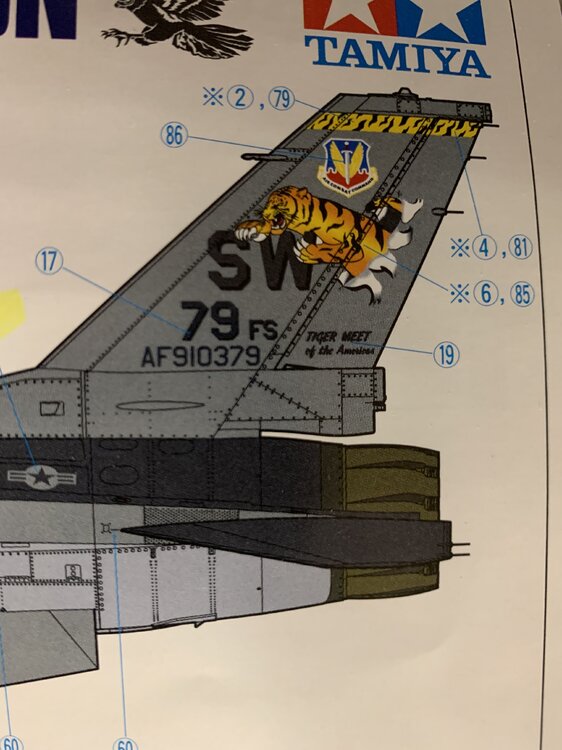

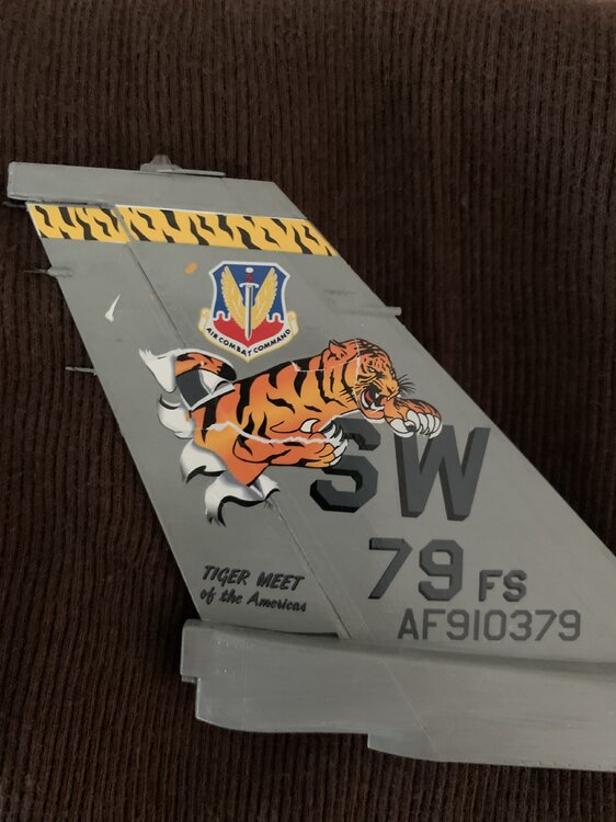

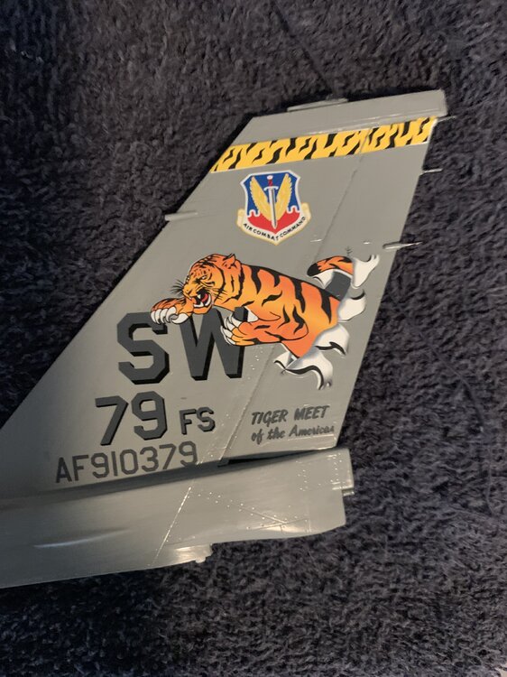

Well the placement of the tail decals was very good on one side and not so much on the other!  The first side went on great and I am very happy with the result.
Unfortunately the tiger tore at several places on the other side.  It went down like a magnet and missed the outline on the lower decal by a lot.  My attempts to raise it off the surface and move it were a disaster but I couldn’t leave it where it was.  This is likely one of those questions that will elicit several answers but I would really like to know what any of you would do in this case.  Matching the colors with paint seems doubtful.  Of course the lazy answer is do nothing and display the model with the good side facing the viewer.😀
Thanks to all for providing your insight into successful model building.
Stuart
If you have not used a decal solvent in it yet, apply decal set, try refloating and repositioning the decals to minimize or correct the tears. The longer that the decal sits, the harder that is to do.
Stik is correct--set the tail face-up and place a few drops of water on the image.  After a few minutes, you should be able to gently remove it and reposition it.
If you've used a solvent, though, you're probably stuck. The only possibilities are to try and re-float and re-position, touch up with paint, or remove it and apply a duplicate decal--you'll have to get another decal sheet.  Or, as you say, it can be the "away" side in the display case.
But whatever you do, use this as a learning experience.  As the oft quoted (and incorrectly used) Beckett line goes: "Ever tried. Ever failed. No matter. Try again. Fail again. Fail better."
