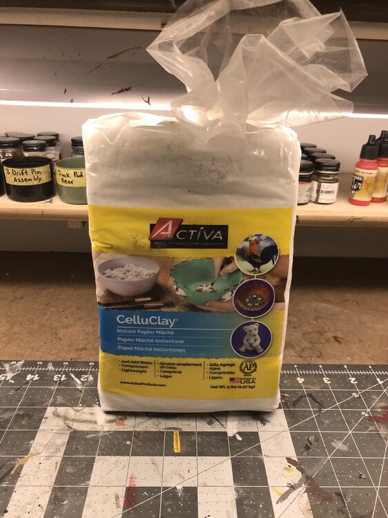

Bradley25mm 40 Posted January 24 Report Share Posted January 24 This is my first time using Celluclay. Up until now, I’ve used pre-mixed sanded grout to simulate dirt. It dries quickly, and dries rockhard . The only drawn back to it, is you cannot add a lot of it to a base. Adds a lot of weight. If anyone has any advice on using CelluClay, I would greatly appreciate any feedback. Chris Link to post Share on other sites
