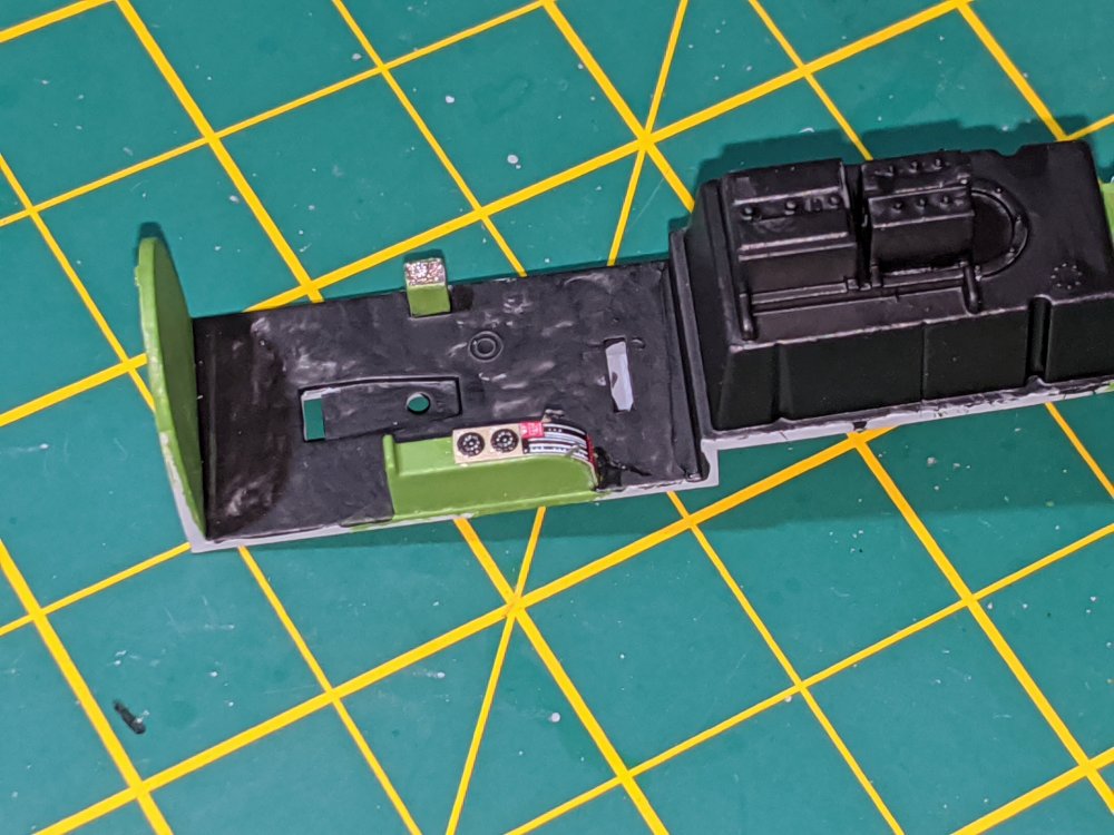

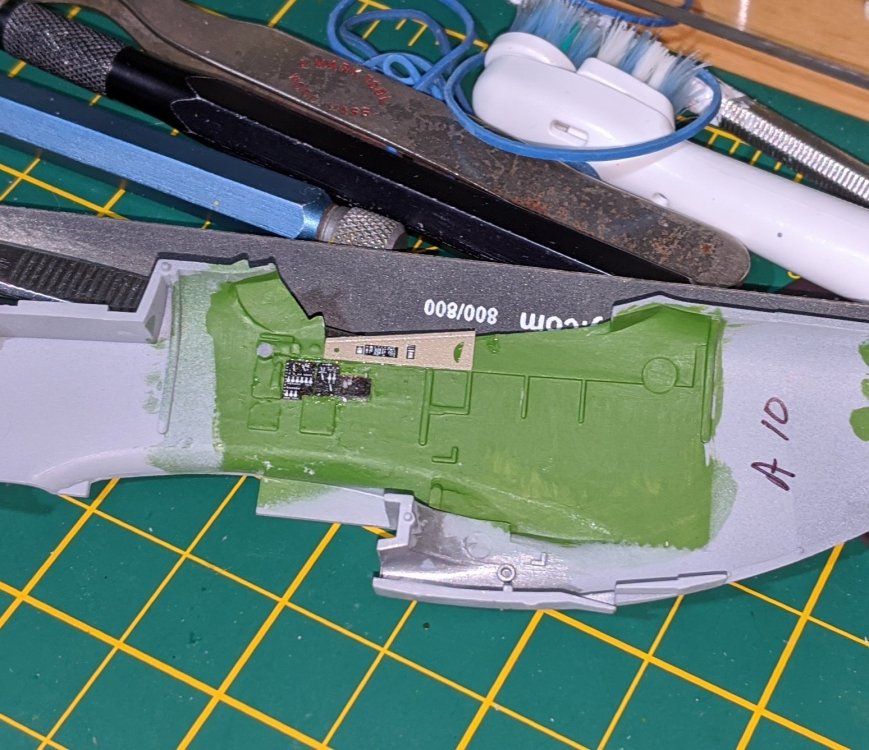

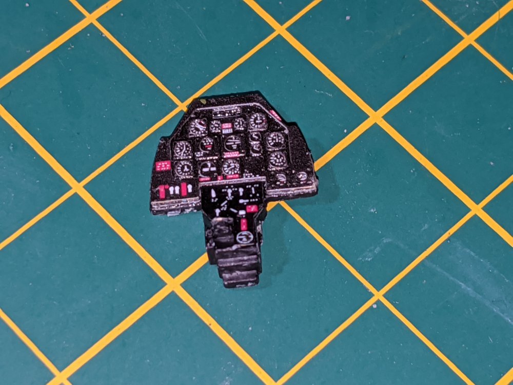

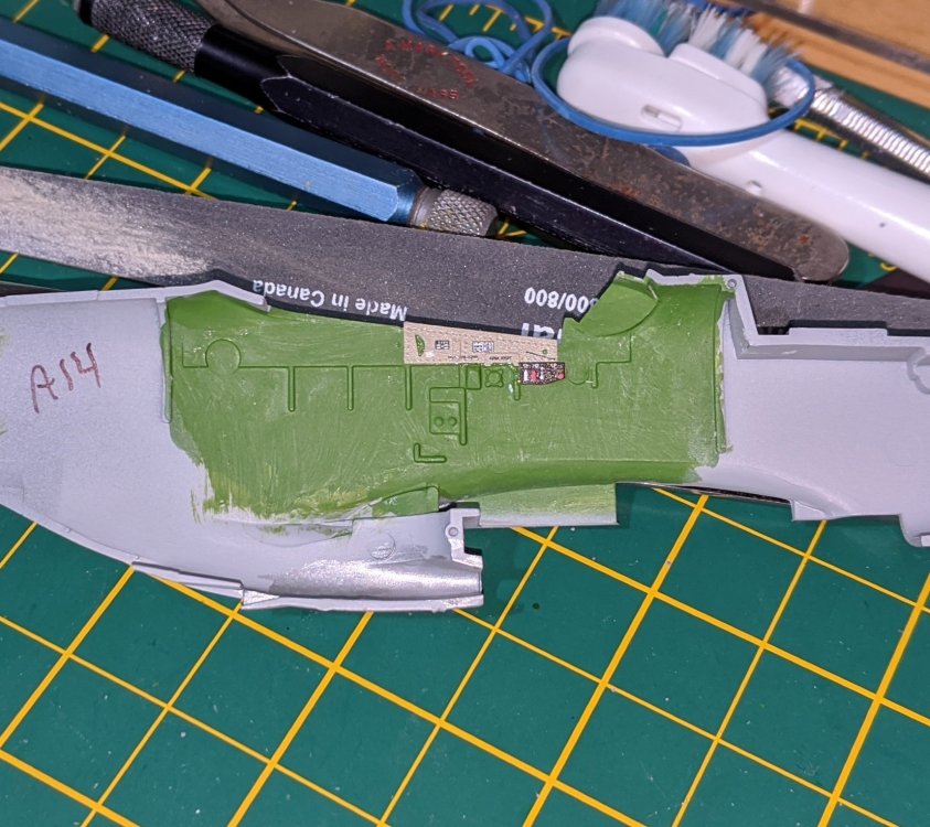

nmertes Posted June 1, 2020 Report Share Posted June 1, 2020 The Accurate Miniatures F-6B that I posted as a WIP sometime ago is almost ready for color so I started on the Tamiya P-51D since it's too hot most of the day to do any airbrushing. I'm using the Eduard PE set that includes the fuselage details. Photo 1 is the left fuselage half. Photo 2 is the right fuselage half. Photo 3 is the instrument panel which includes 5 pieces of PE. Photo 4 is the cockpit floor/battery rack. I've been gluing the PE in place with Ammo by MIG PVA glue except the curved piece on the left side of the cockpit where I used CA. Glued the floor end & let it dry for an hour. Then put a drop of CA on the top section & held it in place for a couple minutes. A question for folks like Gil Hodges or Richard Marmo. How do you remove the stub from PE parts that you've trimmed off the sheet? I've been clipping them off using a small Swiss Army knife scissors then sanding the stubs off with an 800 grit sanding stick. I'm interested in knowing if anybody has a better method. Some of the pieces are extremely small. Link to comment Share on other sites More sharing options...
