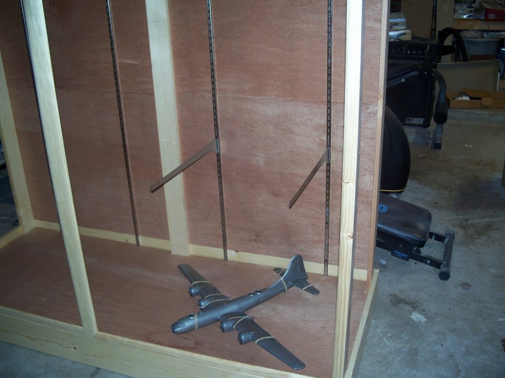

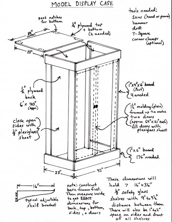

I decided long ago that to work and build on my models and then NOT be able to see them was a waste of my time, so I began building my own display cases. After 35years, I'm well into my 4th (and biggest) display case. They're designed simply, don't require any true "carpentry" skills, have lots of clear, open space for viewing, and the shelving is adjustable. The design can be "sized" to fit your needs...my smallest one designed to fit a narrow entrance hall, while the largest is designed specifically with shelves large enough to hold the 1/48 bombers I build. The cost ranges from $200-$400 each, depending mainly on how much plexiglass and how many glass shelves are used. Commercial display cases do look much nicer, but I've never seen any that hold very many models by comparison, especially if you build airplanes with things that stick out here and there and are sometimes tough to park close together. Anyway..below are the plans and pics of mine....anyone is welcome to them!
Basic plan...common to all of them...
Pic of the last, largest one being built...that's a Monogram 1/48 B-29 sitting in there..

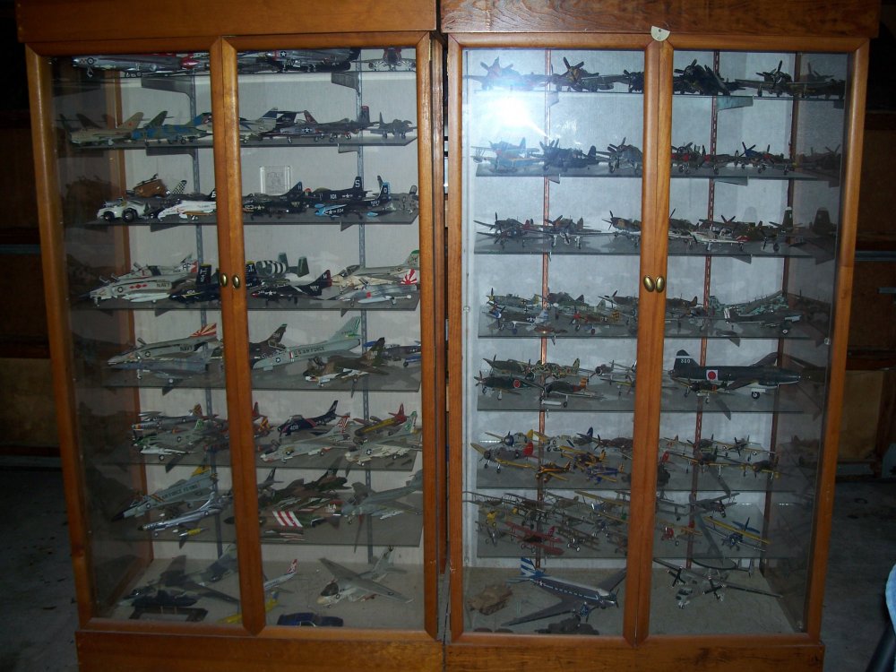

The two oldest (side by side)...each is about 3' wide by 18" deep by 6' tall...

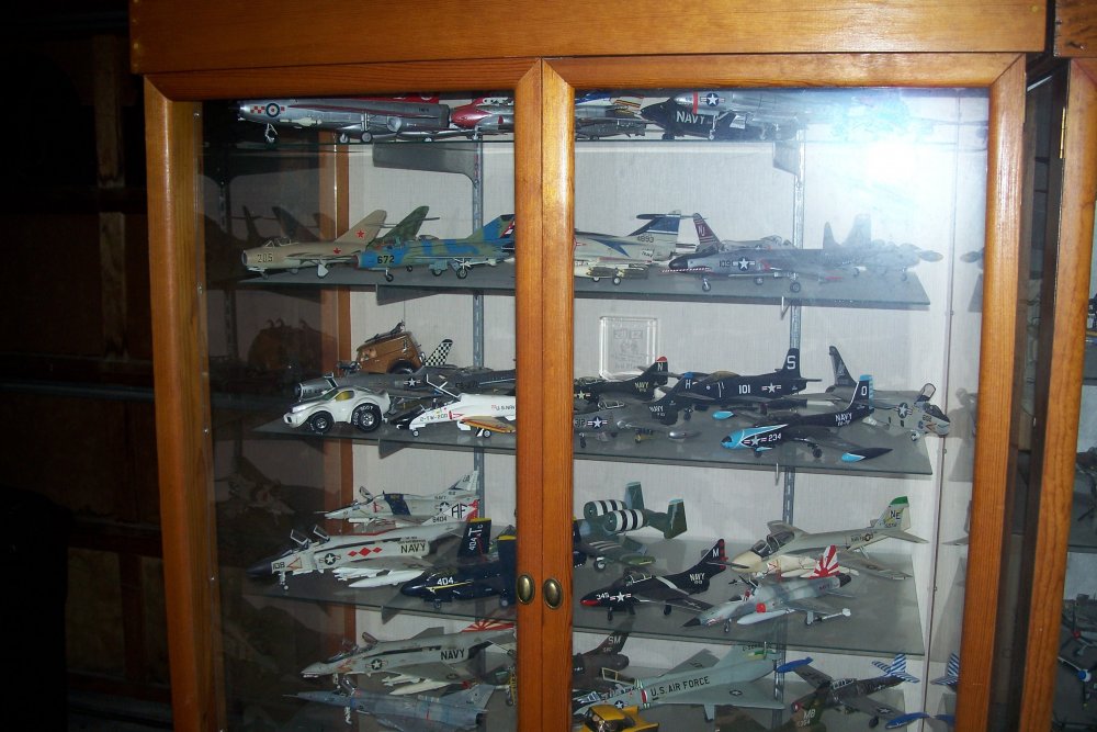

Close up of the left one to show the plain molding used for the door frames...

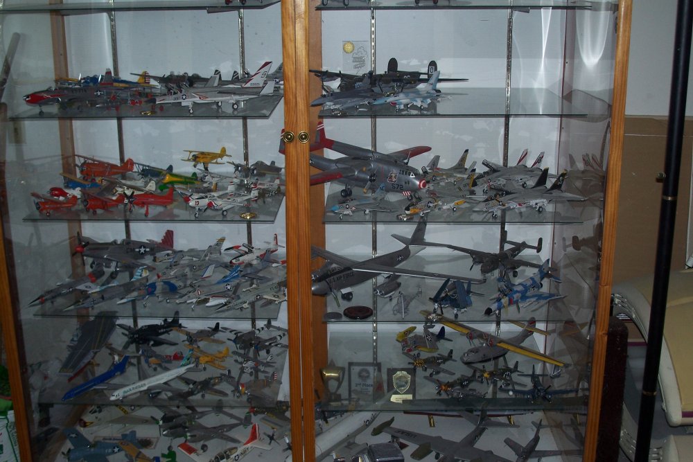

And the largest, with shelves that are 30" wide by 24" deep...note the 1/48 B-24, C-119, B-47, and PBY with room for other models around them...
That last pic is a couple of years old and it's already 3/4 full now; so building another one will be needed within 2-3 years. But, this allows me to keep them all in view, take them in and out relatively easily, and keeps most of them generally dust free compared to any open shelves.  If I can build these anyone can! Hope this helps!

On the doors, are the 4 molding pcs (t,b,r,l) just glued to the plex and the hinges on the outside of them and the cabinet?
Thanks,
John R
The plexiglass is screwed to the molding....so it does take some effort to drill the plexiglass (just use a slow speed), and to find very short screws...but most well stocked hardware stores have them! The molding is fastened together with "L" corner braces....so you learn to live with the doors not being absolutely flush against the case. The door hinges take an effort to find also, as they have to be no thicker than the thickness of the molding you use...but I've always been able to find them in the cabinet section.
