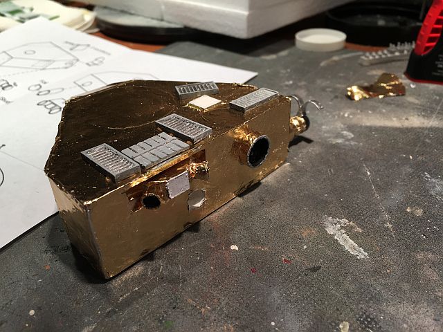

After a while I get tired of wrapping the parts in foil, so I started attaching them to the bus -

Slow going on this one, but progress is being made.

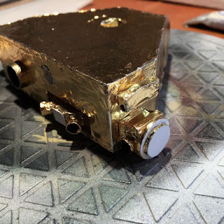

I first attached Alice and Ralph -
