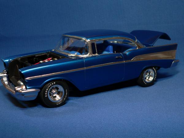

Hey Tim...do you have a pic of the car that you're doing? I did a search and saw a few cars. One was Blue with yellow. Is that the car you're building. If so...I think that Dupli-color Med. Quasar Metallic #BGM 0438 looks like a real close match. I used it on the 57 chev build I did awhile back and it really looks good. If you want it darker...I'd prime the car with red of black....That will make it a lot darker. I used Grey primer on this build.....
Hope this helps you some...
