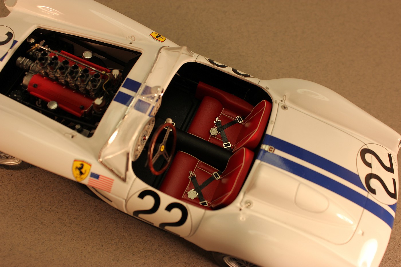

cruz Posted January 28, 2014 Report Share Posted January 28, 2014 Based on a Hasegawa kit. The engine used is a resin product from Historic Racing Miniatures. I also used a photo-etch detail set from KA Models and purchased the Hasegawa tires and rims specifically made for the kit. Paint is Tamiya Pure White without the use of clear. Decals are Carto Graph. Hosted on Fotki Hosted on Fotki Hosted on Fotki Hosted on Fotki Hosted on Fotki Hosted on Fotki Hosted on Fotki Link to comment Share on other sites More sharing options...

ghodges Posted January 28, 2014 Report Share Posted January 28, 2014 Absolutely beautiful! So the white has no clear coat? Did you paint the blue racing stripes, or are they decals? Also, did you paint the piping details on the seats? Very, very crisp work! GIL Link to comment Share on other sites More sharing options...

cruz Posted January 29, 2014 Author Report Share Posted January 29, 2014 (edited) Hosted on Fotki Hosted on Fotki Hosted on Fotki Though the kit's seats have molded in piping, I knew it would be a challenge painting them so I decided to sand them off and use wire. I had to paint the bulge of the hood and match the paint to the rest of the decals because the hood decal would not conform to it. White has no clear. Edited January 29, 2014 by cruz Link to comment Share on other sites More sharing options...

ghodges Posted February 21, 2014 Report Share Posted February 21, 2014 Ok Marcos.....so the white wire is applied for the piping....but exactly how did you apply it? What glue did you use to get such crisp results with no glue marks or marring of the red paint? Thanks! GIL Link to comment Share on other sites More sharing options...
DaveDeLang Posted February 23, 2014 Report Share Posted February 23, 2014 Ok Marcos.....so the white wire is applied for the piping....but exactly how did you apply it? What glue did you use to get such crisp results with no glue marks or marring of the red paint? Thanks! GIL Oh, yes. Inquiring minds want to know! That looks fabulous! Link to comment Share on other sites More sharing options...
cruz Posted February 27, 2014 Author Report Share Posted February 27, 2014 The seats were painted flat red at the start and before applying the piping of course. I grabbed a toothpick and applied very small amounts of crazy glue on the wire first and then went ahead and started pressing it in place slowly and in sections while following the contours of the seats. Make sure the wire is stretched firmly first before applying it. You will surely notice small patches of super glue once done, it's inevitable being that the seat was flat and the glue dries glossy. No need to worry, just lightly add some clear to the seats from a distance. This will give it a slight vinylish look as seen in the pictures. It will tone everything up but make sure you don't go overboard with the clear, you want to achieve a satiny look..... Link to comment Share on other sites More sharing options...
