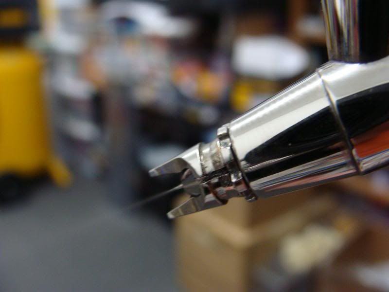

Here it is - an airbrush maintainence tutorial. A lot of people neglect the fact that their airbrush is a precision tool and does need to be maintained. Furthermore, many do not know that all airbrushes are not created equal. Though the general principal is the same, many do not know that the seals in their airbrush are not solvent resistant. This means that running solvent-based paints (lacquers etc.) through your airbrush shrinks, twists, dries out, and essentially dissolves the components that keep your airbrush running smoothly. In the following steps I'll go through what I do to keep my airbrushes in new working order.

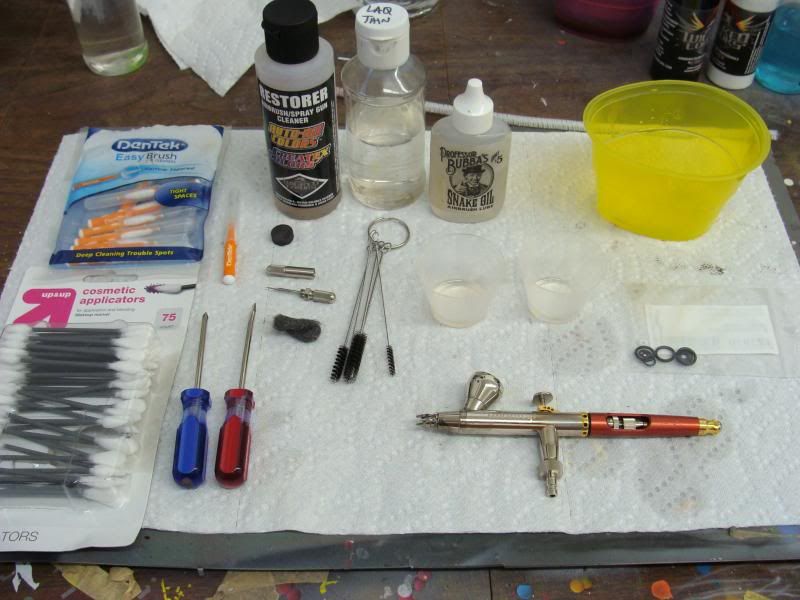

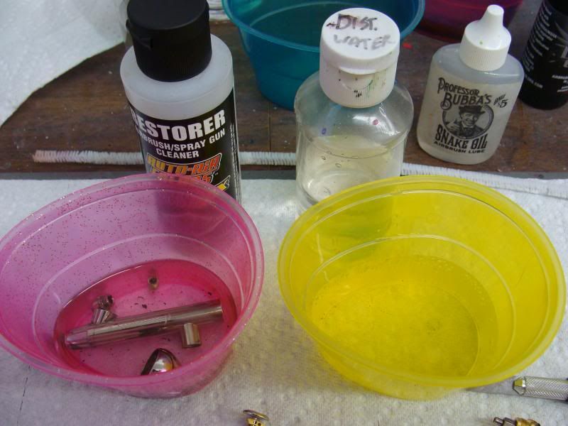

Step 1 - Tools you need - Createx Airbrush Restorer, lacquer thinner, lubricant (Iwata, Badger, and other companies all have a version I use Professor Bubba's mineral oil), cosmetic applicator brushes (I like these due to the flat broad end and the pointed tip work great for airbrush cleaning), Dentech floss brushes, a bit of 0000 steel wool, a set of nylon paint gun brushes or pipe cleaner, containers for the parts to bath/rinse, paper towels, and small tools as necessary - refer to your airbrush's manual.

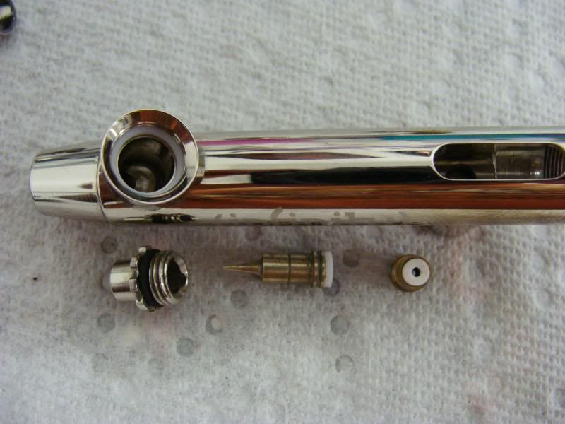

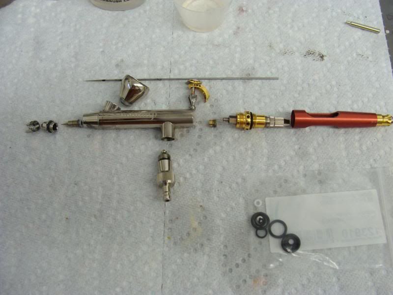

Step 2 - disassembly. I've broken my 'brush down to it's bare components which are the needle cap, nozzle, needle cone, body, air valve, needle, needle packing seal, trigger, needle chuck, and handle
As you can see in the picture the needle packing seal at the back has paint on the outside. This should not happen. The seal's become distorted and air pressure is forcing paint back to the rear portion of the needle.
Step 3 I create a bath with the Createx Airbrush Restorer and distilled water for rinsing. 30 minutes to 2 hours for the airbrush to soak. The restorer will do its thing and loosen water based acrylic paints. I've made sure that all seals are out of the brush as the restorer will also swell up and damage seals.

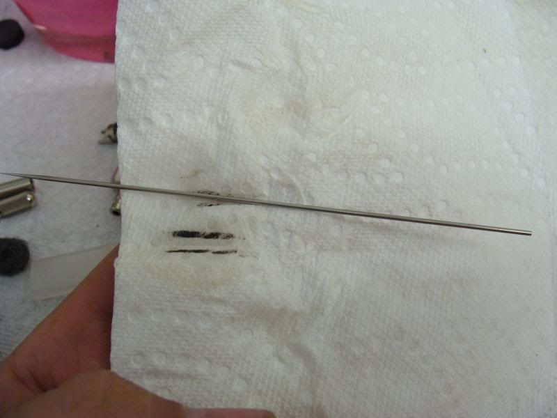

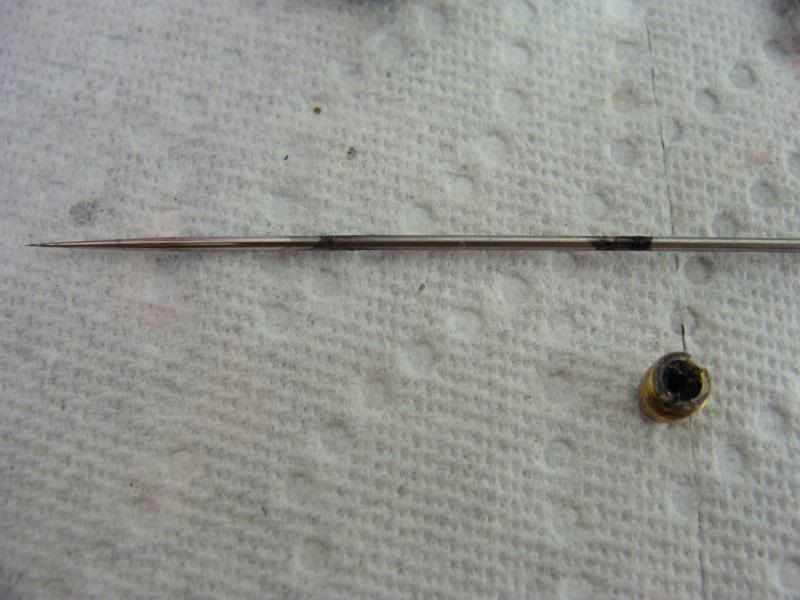

While those parts soak, I take a bit of lacquer thinner and clean off the needle. Be careful as to not croche hook the needle as it's not cheap to replace. After cleaning I give it a couple swipes with the steel wool.

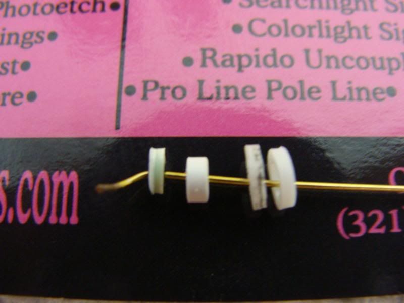

I also pull the bad seals out of the brush. Comparing new to old. The old seals on the left have endured many hours of acrylic, lacquer and urethane paints. They are solvent resistent but not solvent proof. Research your airbrush and it should tell you if you can spray solvents through it or not. The picture shows the needle packing seal is shriveled and about half the size it should be. The other seal is from the nozzle cone and, it too, is narrower in size and slightly ridged on one side. Bad air pressure means bad performance.

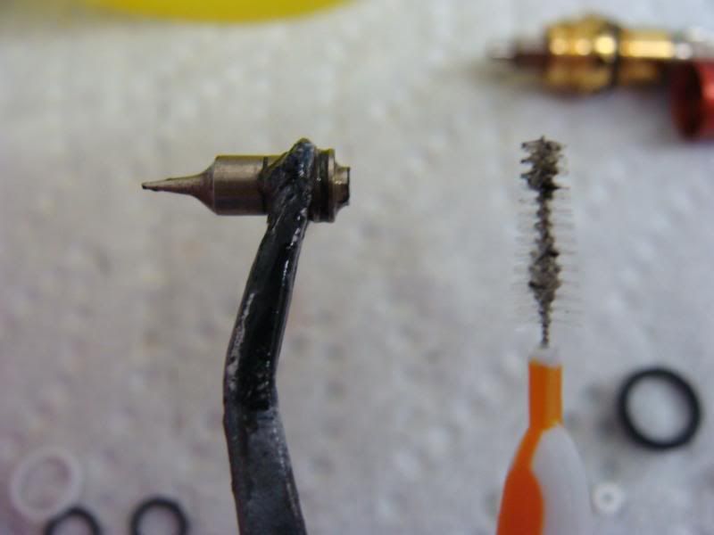

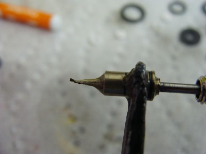

After soaking the parts for a 1/2 hour, I used a Dentech brush to clean the nozzle. The evidence clearly shows that though it may have looked clean, it definitely was not.

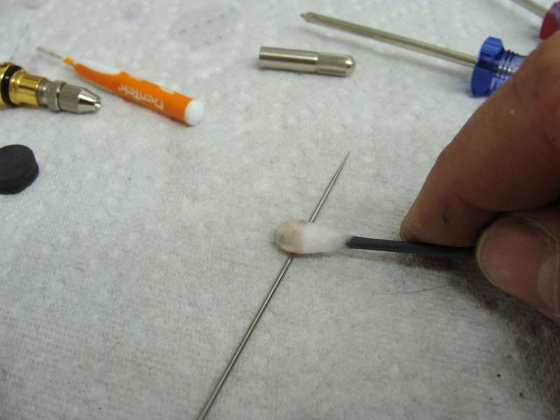

Lubrication begins. Take a drop of oil and just wipe the needle from the front 1/3rd to the tip. This reduces friction at the nozzle and potential for worn and cracked nozzle cones. It also helps keep the paint from sticking to the needle. Also add a drop to the needle chuck assembly so it slides in and out of each other smoothly. IF you so choose a bit of lubricant on the trigger assembly doesn't hurt either.

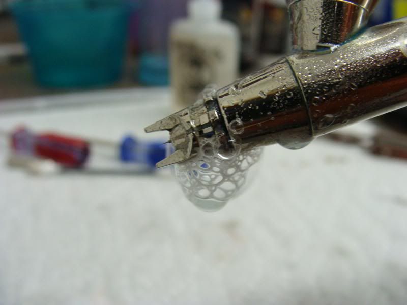

90% of the problems I have encountered with my airbrushes are at the front end nozzle section. A quick way to figure out if you have a leak is to turn on the airbrush and mist a little Windex on the nozzle. Bubbles means an air leak and bad seal and bad performance. If you are getting bubbles in the paint cup, you have a nozzle blockage forcing the air back in to your airbrush and not letting air and paint through.
