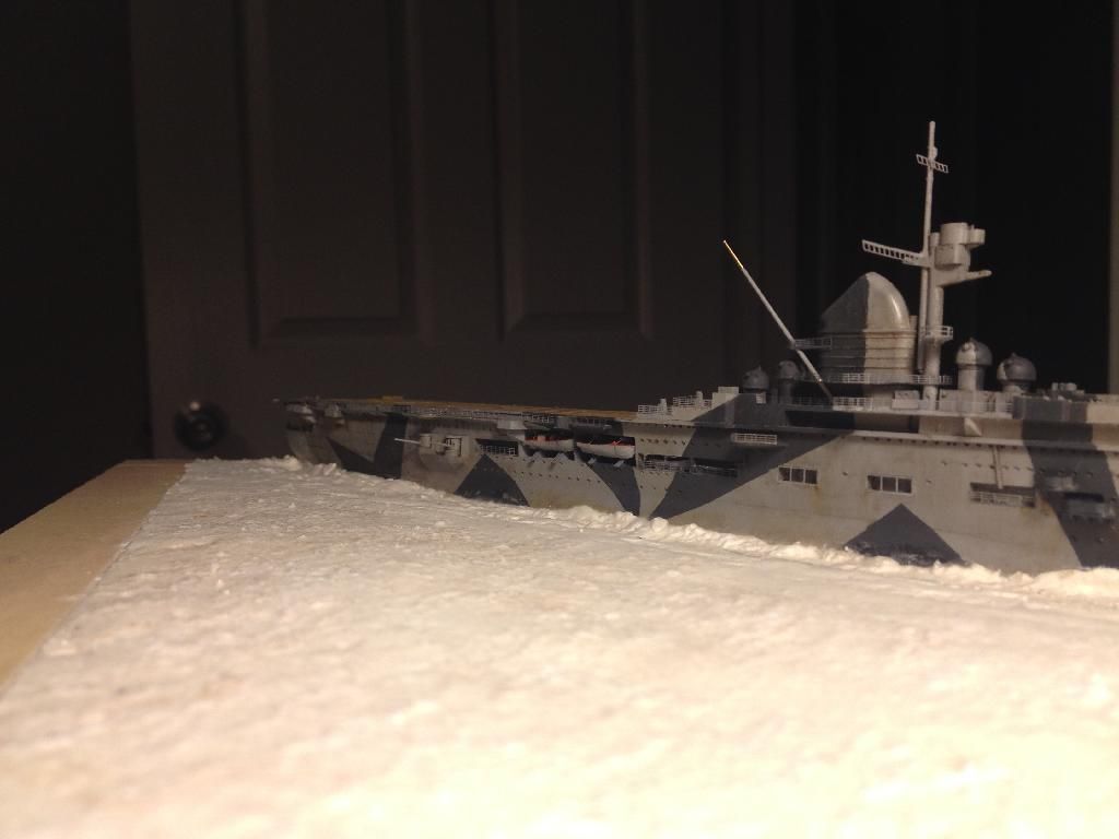

One benefit to having the hull glued to the wood at this stage is that you don't have to juggle the ship with your hands while you simultaneously try to super glue to affix some minor part, subassembly, or PE whatever. The board becomes the extra two hands that you need.

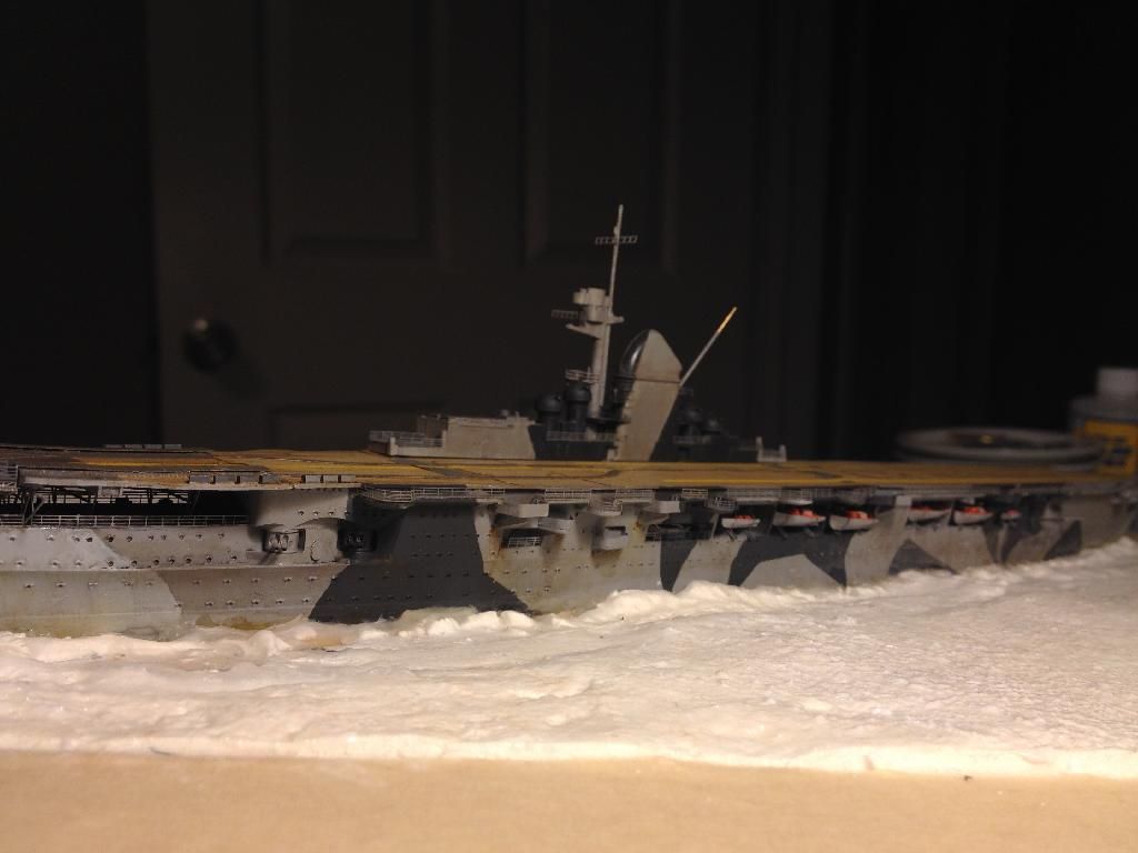

I admire your speedy recovery on the first solid water trial. The plaster water looks great even while still in white. One suggestion with the plaster mix for water is to mix your wet plaster with acrylic seawater color. Thus, you will have solid colored plaster base material for its entire thickness. When dry, you can still add different colors to the outer surface of the plaster for foam, green sea, etc., and your clear coats will just add to the illusion of depth.

HM... good idea, Ed. Thanks. I plan on painting it a solid color once the model gets her dullcoat. I'm going to use some progressively lighter colors, thinned, around disturbed areas of the ship. I'll then use some teased cotton/tissue to make the "foam" part of the waves. The eventual goal is a VERY angry sea.

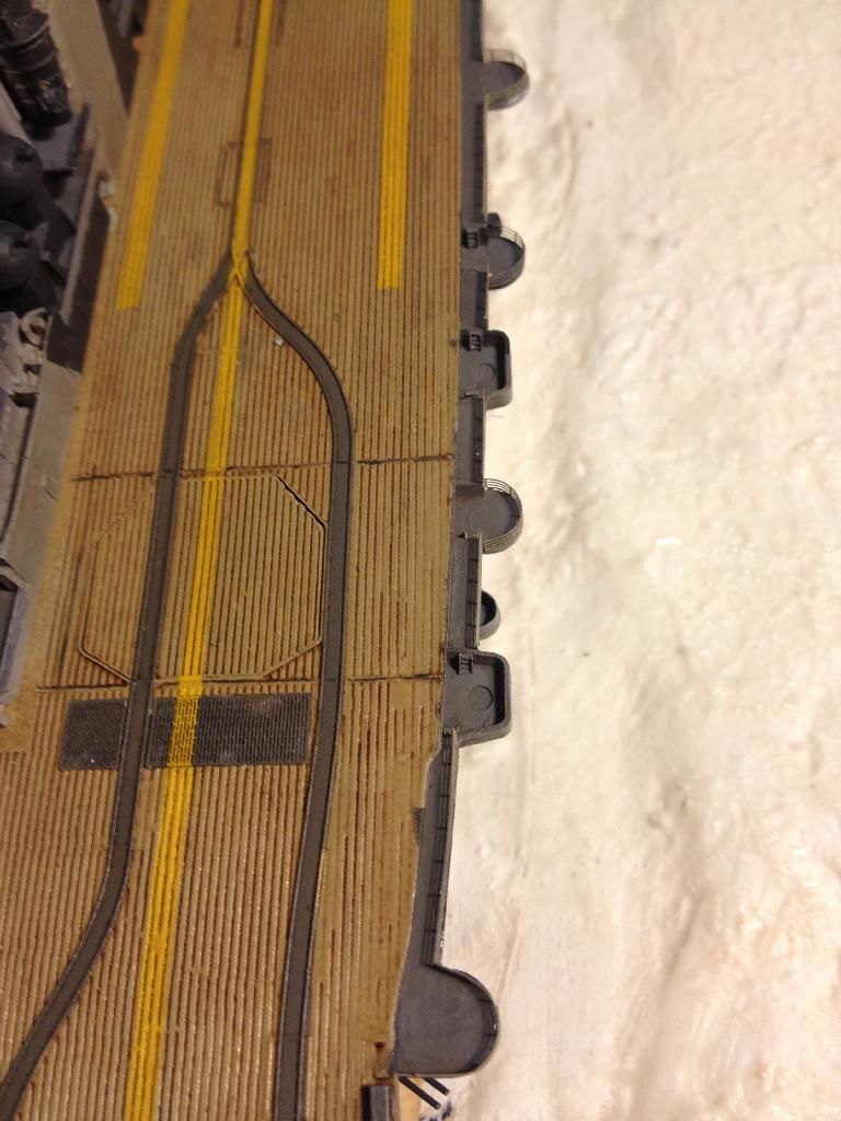

Anyway. Pictures. I've added all the railing that I can. I'm going to use Gatorglue to provide a seal along the base of the railings (seam elimination) and then touch up the PE to match the camouflage color that at point of the hull. It'll be gloriously tedious.
On the bright side, it's getting done.

Can you see the little steps? Let's call them kitchen step stools, like Mom used to use. They're like that, only in 700 scale. I'm fairly certain Orange Hobby included them just to raise my blood pressure!

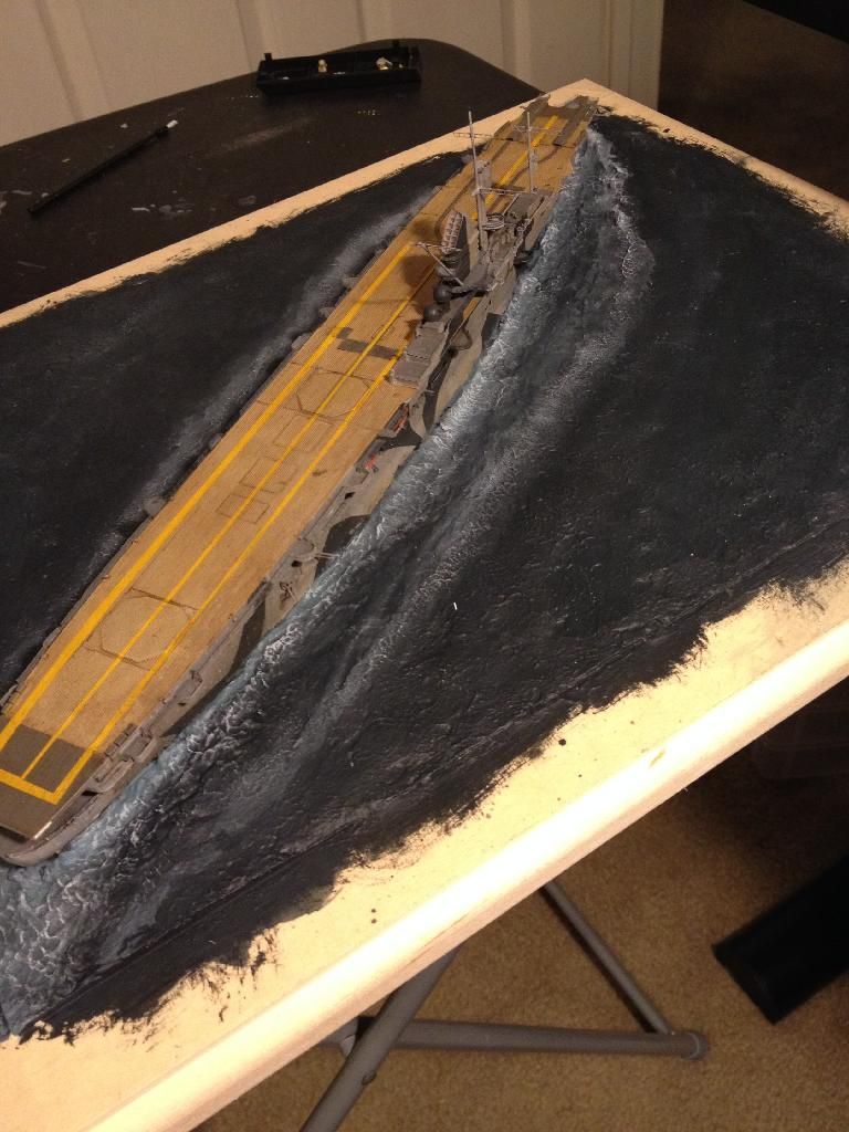

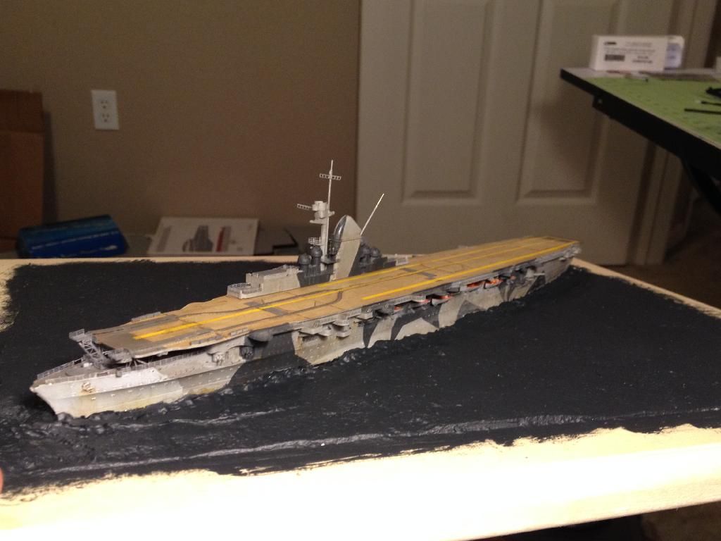

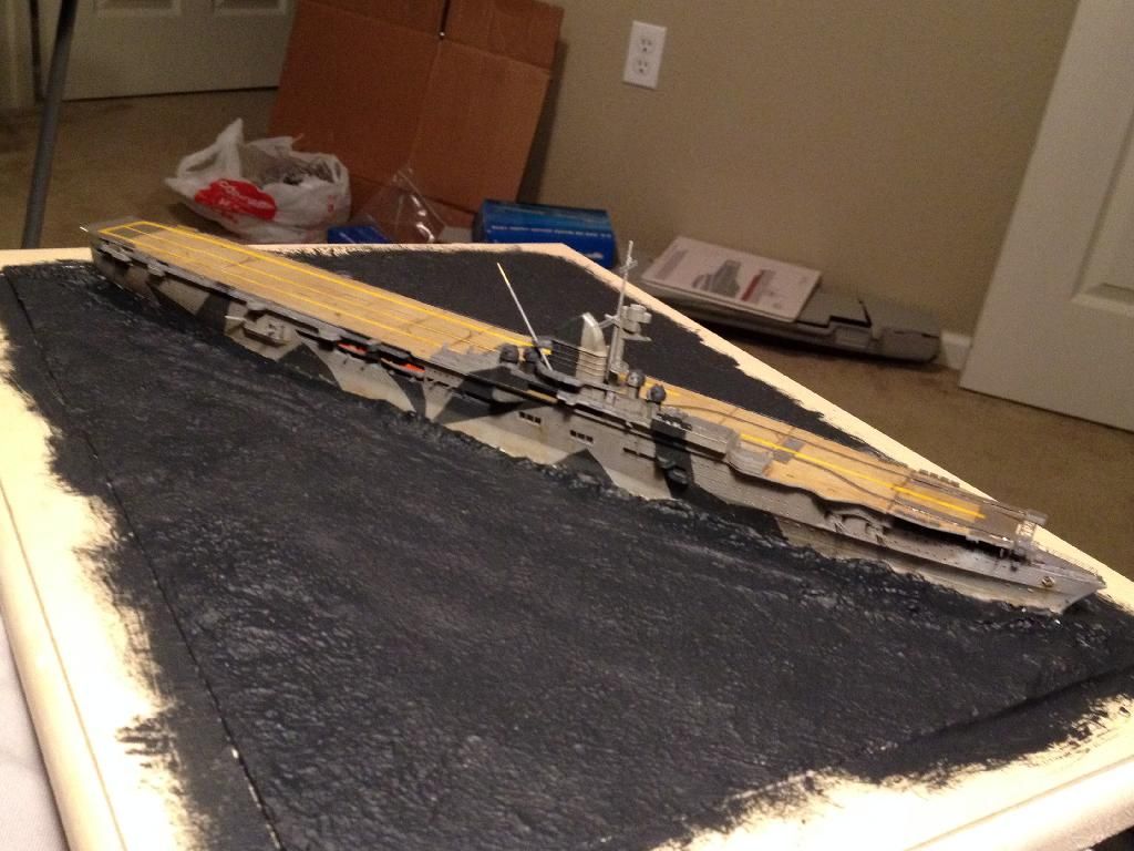

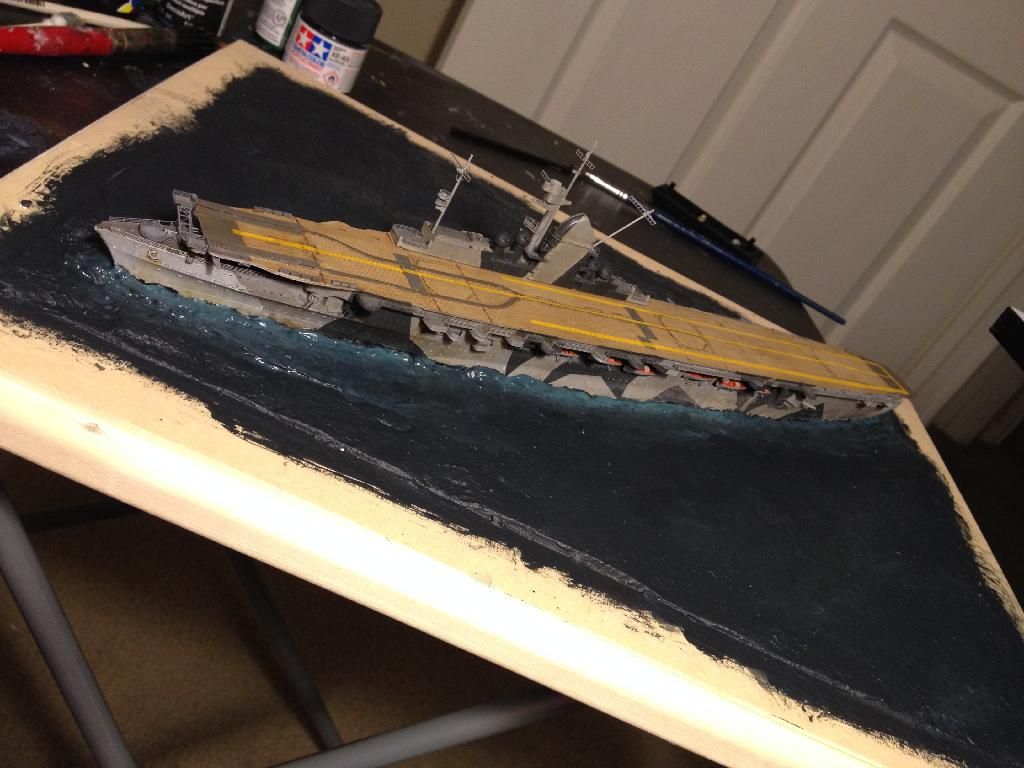

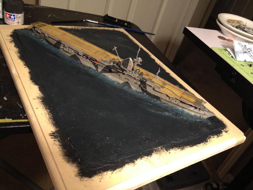

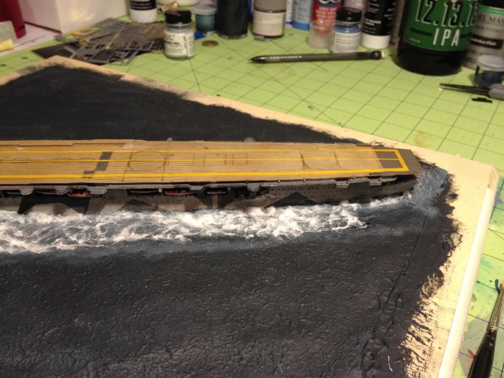

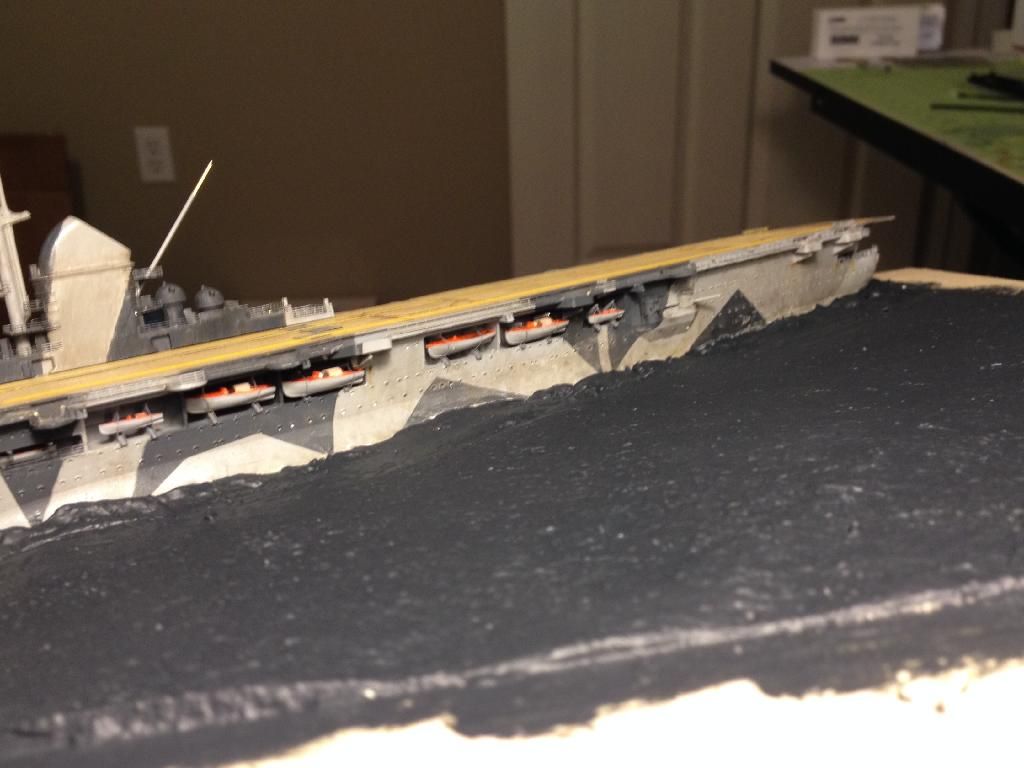

I was tired of looking at a white sea, so I threw a base coat on it. Obviously, the water is rather dull at this stage, but at least it has a base color. The color is a 2:1:1/4 of Black, midnight blue, and forest green. My goal is a dark, stormy North Atlantic sea. I'll start prepping the actual swell and turbulence this week. I also did some remedial paint work on the railings, which is hard to see.
Hopefully, she gets her full AA load today.
039FF2AB-807B-4C07-B914-A8C2D5CB8796_zps
FEC266BB-849A-4429-99CD-2F3932F90E87_zps
1E5D57F1-BE7E-4486-941C-FE9211CEA1E1_zps
FDE08CF0-5123-45B6-A670-01F02C7CFFE4_zps
I like the color choice. It compliments the camo, showing why the dark grays are appropriate.
The PE is really looking good! Very interested in the process to manufacture some waves.

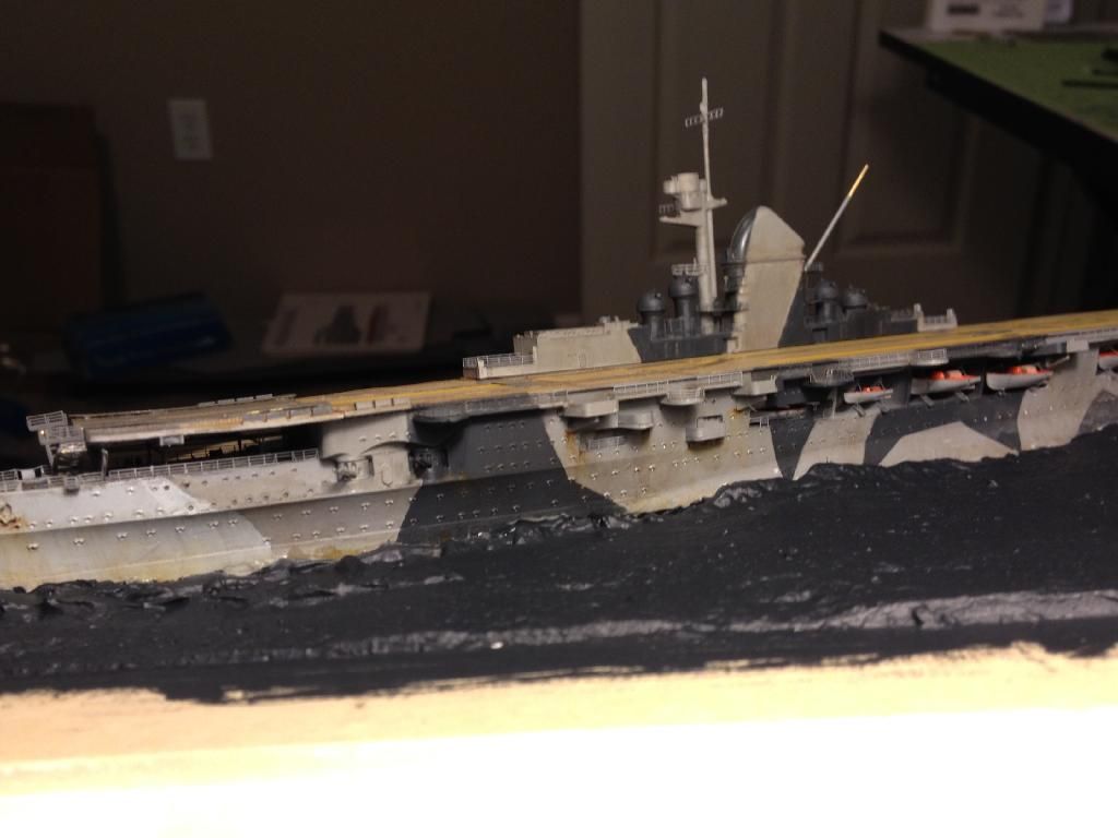

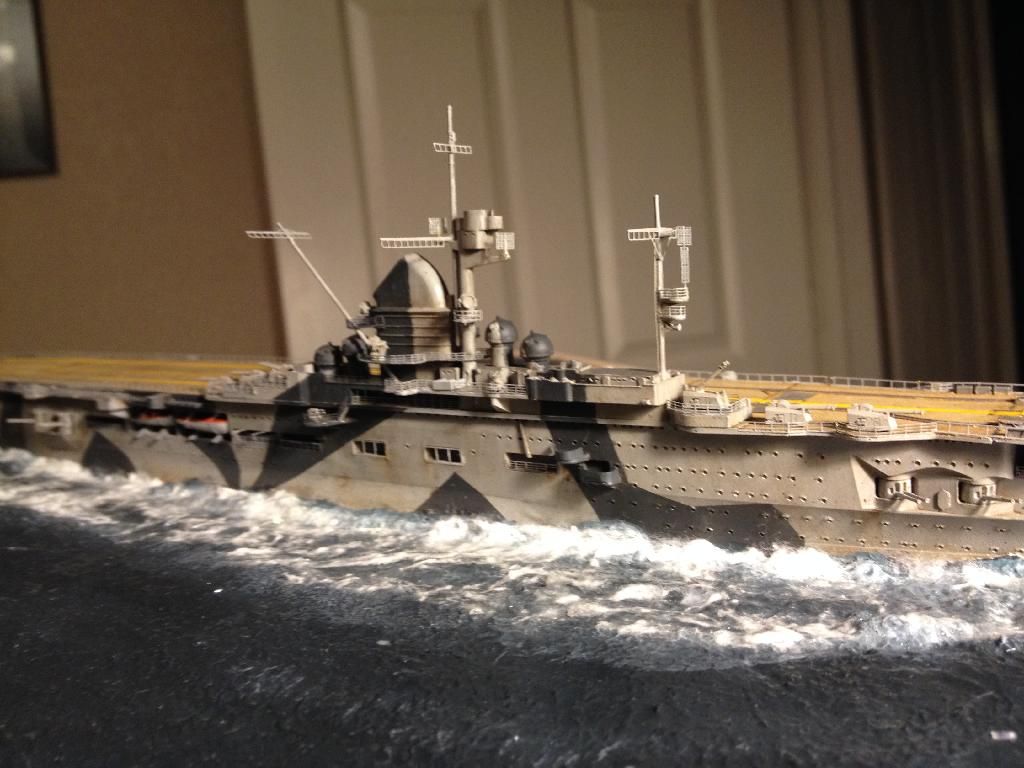

I've also finished adding the masts, minus radar. The Zepp also has her forward AA platform and port/starboard radar stations. Railing is mostly painted and sealed with Gatorglue to hide seams.
Tomorrow: Add some crew/PE. I'll also start assembling all the tiny little AA guns.

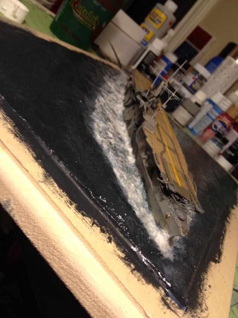

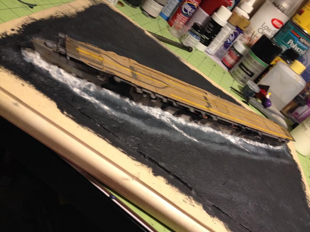

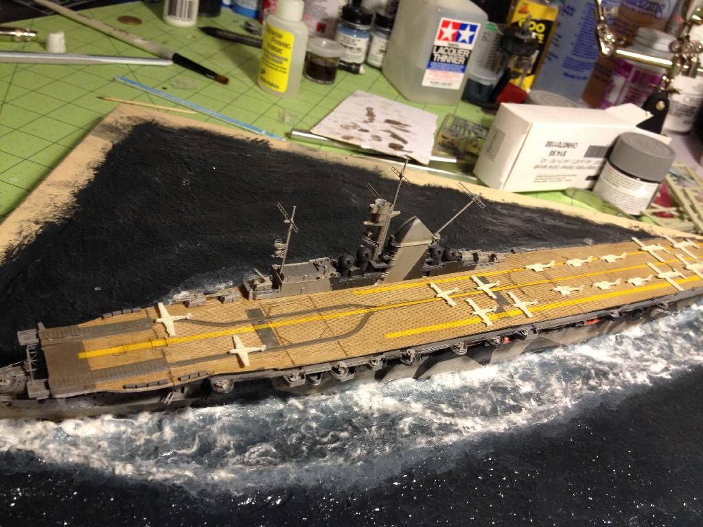

Experiment number... something. I've been talking with a lot of REALLY good builders like Chris (sargentx) on how to better work a water base. I've been trying to incorporate his excellent work into 700 scale with a little bit of my own flair thrown in for, well, some originality.
Here's what I did.

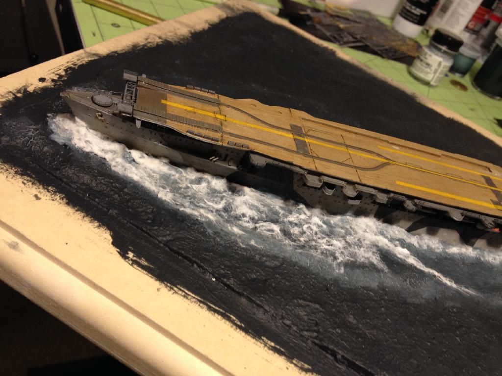

1) Painted base as shown. I started with faint lines along where major wakes would be seen off the ship. I then expanded it to the desired level of disturbance. Painting was done with thinned cheap acrylics and dry brushing. My goal is to provide a nice base for the cotton and upper layers.
321BEA8C-DC05-4EB5-9D57-9C1F54FA8653_zps
2) Teased out cotton, adhering it to the base with gel medium.
I started by tracing where I wanted retreating wakes to be located.
97E5D030-B03E-4068-BFDC-18AF32A4A975_zps
This was followed by filling in the area with cotton.
1B13FD6B-5C3E-4DF2-A4F2-14838603A901_zps
73C32EE3-D1C3-49D5-A09D-AD1D5A9D310D_zps
This is a slow process, but worth it.

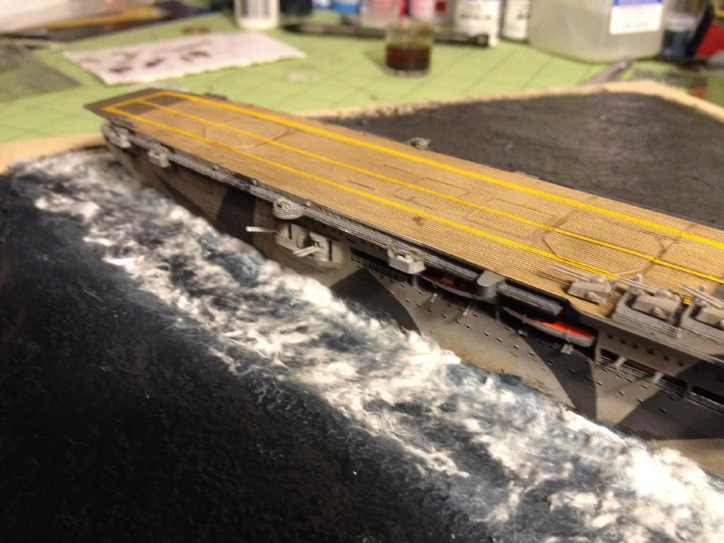

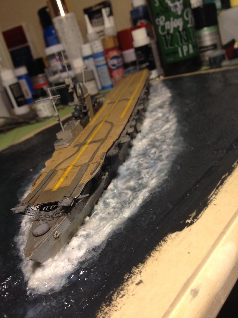

3) (Current stage) I painted down a layer of gloss varnish to seal the layer into the base. I am still planning on doing a layer of resin for depth, but this gives an idea of what it will look like.
0AF6BC30-BAAE-46F0-9465-6404243820A4_zps
8A78F8A8-BAE8-44C7-9A95-73681EA30541_zps
Once I seal in the base, I'll build some "foam" out with Chris's method of gloss gel medium + cotton. I'll also use some of Jim's technique with tissue to keep it in scale.

That's truly some stormy seas. Wonderful technique. The colors really portray the dark North Sea feel.

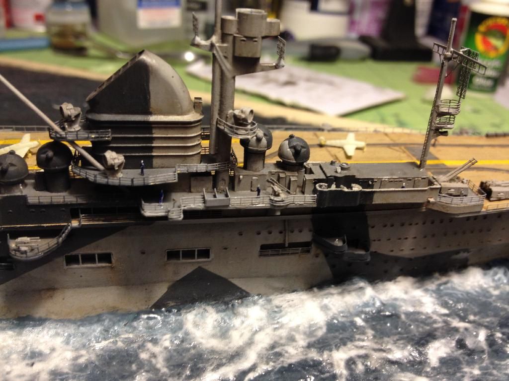

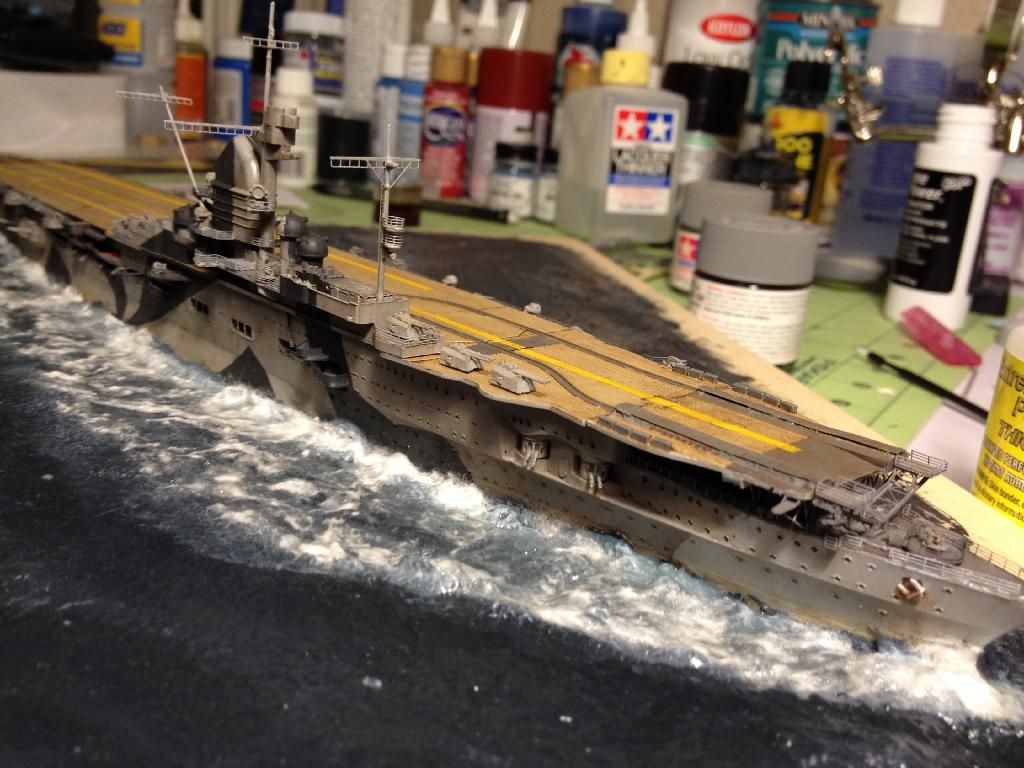

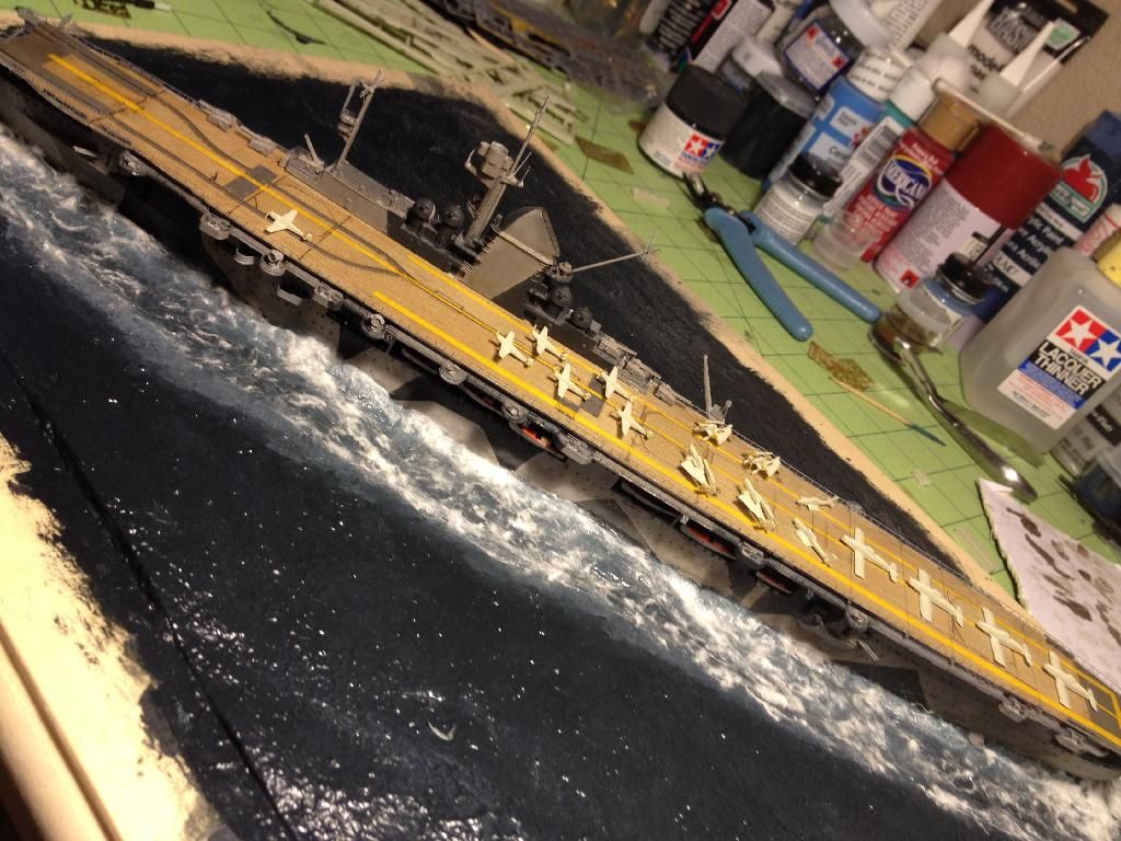

HUGE update, though it doesn't look like it. All the ships AA (minus two guns I forgot to make) have been added. Searchlights are on, and most of the construction is FINISHED (minus air group.)
I'll be adding her crane once I get the deck railing in place. If I have time tonight, I'll begin THAT job.
Biggest task left: Air wing. Once they're done, I'll clean her up a bit, rig her island, add some small details and dull coat the boat. The water will then be coated in resin. The final act will be finished off the bow wave.
351C4B76-BBD9-49AA-91A1-F3806A0B0DF8_zps
EFCF495A-B83A-4AB5-B4E3-7932C0BD14D7_zps

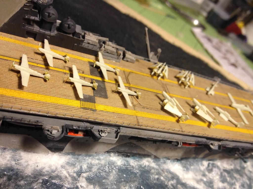

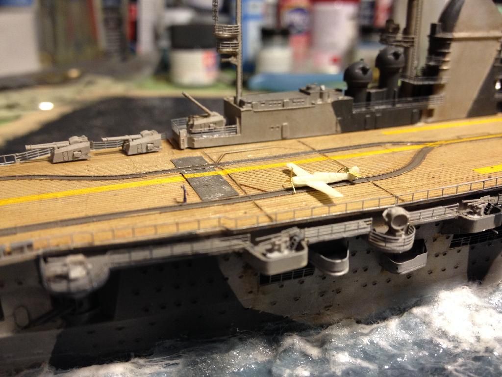

Last update. I installed this TINY little ladder to the AA gun platform and... tore some stuff up. I'm going to have to do some serious touch up painting. Still, glad I installed it.
10E5C855-BB05-4522-812C-50B8E3662426_zps
Here's the air wing. I'm seriously considering getting ONE more package of DKM naval aircraft. It'll look cool.
723A678A-B8DE-4238-A856-0FC3F3B493BF_zps

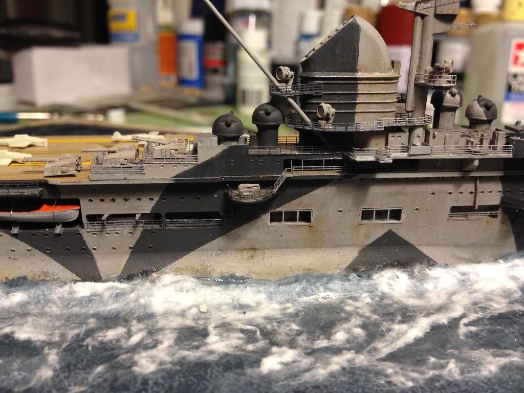

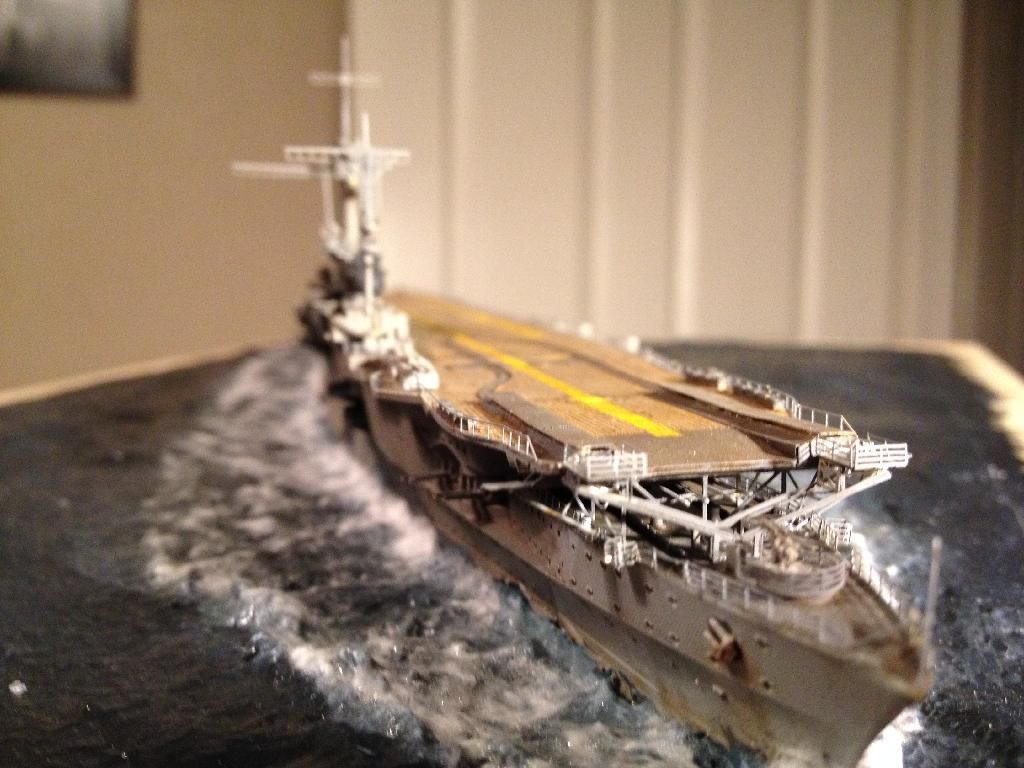

I've installed the railing that would have been in place when she was not conducting flight ops. I also added some Caenis thread where she would have had her arresting system.
B237038C-C93E-4201-ABED-6B6993A6CFA5_zps
The island her her full load out of radar. I'm only missing the rigging (scary) and figures.
910A1F65-56B1-45AB-8C4D-A85FA497FC80_zps
Bow view... just because.
FC01656C-3881-4D2F-A64A-AC86CCE8F0F5_zps
I honestly cannot wait to finish this build She's gonna be nice once I touch up any remaining brass and finish off the stormy sea. Her air wing will add more color.
Opinions welcome.
Oh wow, that is fantabulous! Gotta love the bow shot! That is some truly amazing work Chris, mine looks like a toy compared to this! Can't wait to see more!
