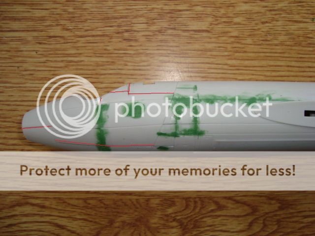

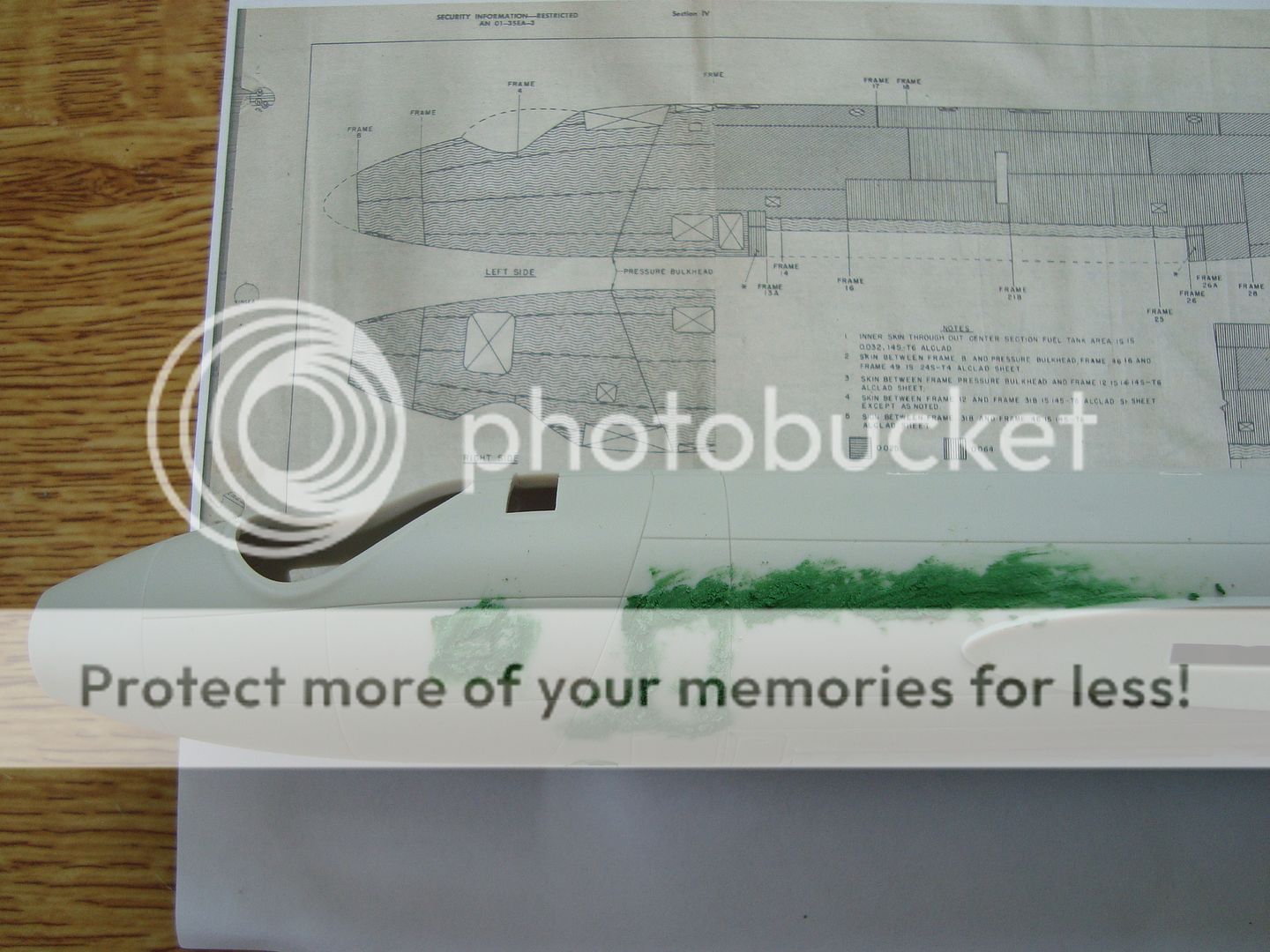

Let battle commence! First job is to fill the panel lines that are not applicable to the B.57A, or indeed the Canberra B.2, luckily there isn't that much. As you may be able to see from the drawing behind the model I'll need to add a few extra panels though.

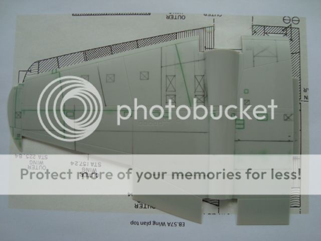

And the same process underway on the wings, those of you who watched the B.57G build will be familiar with the work involved. This wing differs in that it will be the four x.50 cal. wing.

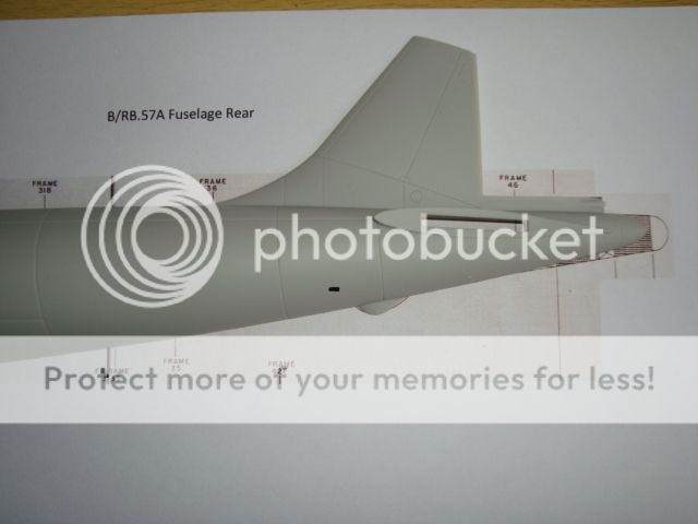

I've scanned the drawings in the B.57A Repair manual and I've discovered another potential shape issue with the Airfix Canberra. The front end is just about spot on the only slight problem is the extreme nose being a bit off, but nothing major. The thing I picked up is the extreme tail end as you will see from the following photo Airfix may have made this area a bit on the thin side, as yet I'm not 100% sure if this is right or wrong I suspect there are two types of tail cone one with a tail warning radar as in the drawing and one without which is more like the kit . I'm still trying to work it out, but either way it's nothing too bad, if it is right and if you want to get it right it will need fixing. Will I fix it? I don't know, not this time! If it is right then it could apply to Every Canberra except the B.57E. Also of note is the miss match of the frames.
Work is well underway with the filling and re-scribing. As you will see from the following photos I'm concentrating on the fusalage first. I've marked out the newly engraved panels in red.

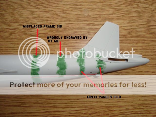

This next photo showing the work on the rear fuselage. The panel line I've had to fill that I wrongly placed was down to the fact I was using Airfix's misplaced Frame 31B as the datum for my measurements. I'll re-engrave the frame 31B further forward, then start again. Of the four filled lines, the one third from the left doesn't exist on the aircraft and the forth needs moving to the right.

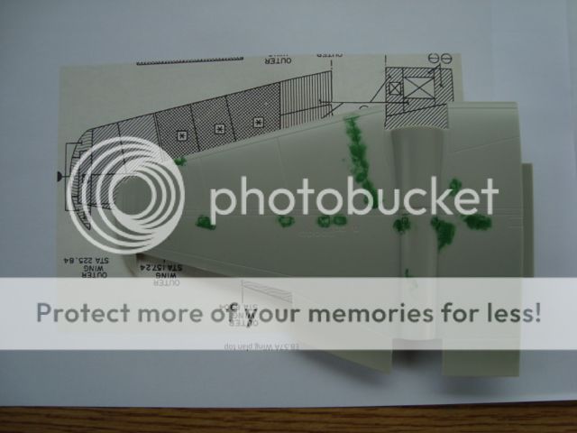

And so, on to the wings. I've filled all the non applicable Airfix panel lines and drawn on the new B.57A ones. The ones with the "X" in the centre are hatches.

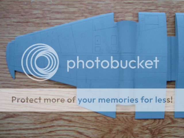

That's the upper wings done. smile.gif I've now started on the underside, I don't know why, but I've found the .50cal. wing harder going than the 20mm one but not too bad I guess.

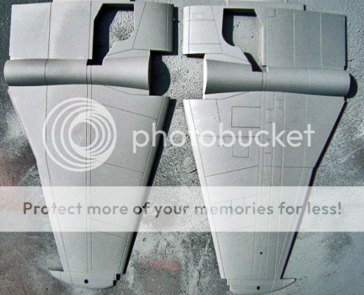

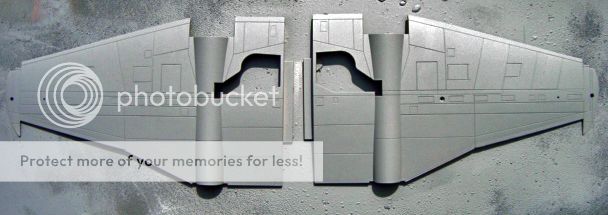

The underside is all engraved now too, I've taken a photo of an unmodified wing for those that aren't familiar with the kit. I hope you can see an improvement :) There is quite a lot more to do on the under side than the top, which is a bit of a shame as it won't be seen!
